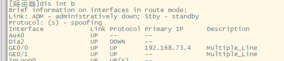

---- More ----%Dec 6 09:21:15:304 2021 路由器 IFNET/3/PHY_UPDOWN: Physical state on the interface Virtual-Access0 changed to up. %Dec 6 09:21:18:195 2021 路由器 IFNET/5/LINK_UPDOWN: Line protocol state on the interface Virtual-Access0 changed to up. %Dec 6 09:21:18:214 2021 路由器 IFNET/5/LINK_UPDOWN: Line protocol state on the interface Virtual-Access0 changed to down. %Dec 6 09:21:18:230 2021 路由器 IFNET/3/PHY_UPDOWN: Physical state on the interface Virtual-Access0 changed to down. %Dec 6 09:21:23:802 2021 路由器 IFNET/3/PHY_UPDOWN: Physical state on the interface Virtual-Access0 changed to up. %Dec 6 09:21:26:696 2021 路由器 IFNET/5/LINK_UPDOWN: Line protocol state on the interface Virtual-Access0 changed to up. %Dec 6 09:21:26:721 2021 路由器 IFNET/5/LINK_UPDOWN: Line protocol state on the interface Virtual-Access0 changed to down. %Dec 6 09:21:26:789 2021 路由器 IFNET/3/PHY_UPDOWN: Physical state on the interface Virtual-Access0 changed to down. %Dec 6 09:21:32:323 2021 路由器 IFNET/3/PHY_UPDOWN: Physical state on the interface Virtual-Access0 changed to up. %Dec 6 09:21:35:194 2021 路由器 IFNET/5/LINK_UPDOWN: Line protocol state on the interface Virtual-Access0 changed to up. %Dec 6 09:21:35:223 2021 路由器 IFNET/5/LINK_UPDOWN: Line protocol state on the interface Virtual-Access0 changed to down. %Dec 6 09:21:35:267 2021 路由器 IFNET/3/PHY_UPDOWN: Physical state on the interface Virtual-Access0 changed to down. %Dec 6 09:21:40:839 2021 路由器 IFNET/3/PHY_UPDOWN: Physical state on the interface Virtual-Access0 changed to up. %Dec 6 09:21:43:724 2021 路由器 IFNET/5/LINK_UPDOWN: Line protocol state on the interface Virtual-Access0 changed to up. %Dec 6 09:21:43:741 2021 路由器 IFNET/5/LINK_UPDOWN: Line protocol state on the interface Virtual-Access0 changed to down. %Dec 6 09:21:43:757 2021 路由器 IFNET/3/PHY_UPDOWN: Physical state on the interface Virtual-Access0 changed to down.
路由器接了两台外网,g0/0是光猫自动获取新接入的,g0/1是PPPOE拨号,dia2,以前在0/1配了nat映射,光猫接进来就没用了上面的是告警

 拨号的账号有问题或者运营商侧异常,因为目前的信息拨号是不成功的。
建议直连运营商测试看看,如果正常则检查核对下配置。反之联系运营商。

如果拨号正常,这个故障可以不用关注
