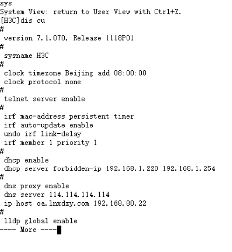

# version 7.1.070, Release 1118P01 # sysname H3C # clock timezone Beijing add 08:00:00 clock protocol none # telnet server enable # irf mac-address persistent timer irf auto-update enable undo irf link-delay irf member 1 priority 1 # dhcp enable dhcp server forbidden-ip 192.168.1.220 192.168.1.254 # dns proxy enable dns server 114.114.114.114 ip host ***.*** 192.168.80.22 # lldp global enable # password-recovery enable # vlan 1 # vlan 2 to 5 # vlan 8 # vlan 100 # stp global enable # dhcp server ip-pool 1 gateway-list 192.168.0.1 network 192.168.0.0 mask 255.255.255.0 dns-list 192.168.0.1 expired day 0 hour 0 minute 30 static-bind ip-address 192.168.0.143 mask 255.255.255.0 hardware-address 9c32-ce59-525b # dhcp server ip-pool 2 gateway-list 192.168.1.1 network 192.168.1.0 mask 255.255.255.0 dns-list 192.168.1.1 expired day 0 hour 0 minute 30 static-bind ip-address 192.168.1.7 mask 255.255.255.0 hardware-address 94c6-91d5-c42f static-bind ip-address 192.168.1.9 mask 255.255.255.0 hardware-address 6c4b-90c5-3939 static-bind ip-address 192.168.1.25 mask 255.255.255.0 hardware-address 2004-0ff7-e190 static-bind ip-address 192.168.1.45 mask 255.255.255.0 hardware-address 44a8-4224-50fc static-bind ip-address 192.168.1.52 mask 255.255.255.0 hardware-address 3448-edf9-3840 static-bind ip-address 192.168.1.54 mask 255.255.255.0 hardware-address 5405-db04-c012 static-bind ip-address 192.168.1.76 mask 255.255.255.0 hardware-address 0201-5cd4-1a84 static-bind ip-address 192.168.1.77 mask 255.255.255.0 hardware-address 0203-2161-222e static-bind ip-address 192.168.1.100 mask 255.255.255.0 hardware-address 0894-ef0f-76b6 static-bind ip-address 192.168.1.102 mask 255.255.255.0 hardware-address 0894-ef0e-eebc static-bind ip-address 192.168.1.188 mask 255.255.255.0 hardware-address 000a-f7ec-daf0 static-bind ip-address 192.168.1.189 mask 255.255.255.0 hardware-address b026-2840-8c10 static-bind ip-address 192.168.1.190 mask 255.255.255.0 hardware-address 6c2b-59c1-e979 static-bind ip-address 192.168.1.191 mask 255.255.255.0 hardware-address 6c2b-59be-85ae # dhcp server ip-pool 3 gateway-list 192.168.2.1 network 192.168.2.0 mask 255.255.255.0 dns-list 192.168.2.1 expired day 0 hour 0 minute 30 # dhcp server ip-pool 4 gateway-list 192.168.3.1 network 192.168.3.0 mask 255.255.255.0 dns-list 192.168.3.1 expired day 0 hour 0 minute 30 # dhcp server ip-pool 5 gateway-list 192.168.4.1 network 192.168.4.0 mask 255.255.254.0 dns-list 114.114.114.114 expired day 0 hour 0 minute 30 # dhcp server ip-pool 8 gateway-list 192.168.8.1 network 192.168.8.0 mask 255.255.255.0 dns-list 114.114.114.114 expired day 0 hour 0 minute 30 # interface NULL0 # interface Vlan-interface1 ip address 192.168.1.1 255.255.255.0 # interface Vlan-interface2 ip address 192.168.0.1 255.255.255.0 # interface Vlan-interface3 ip address 192.168.2.1 255.255.255.0 # interface Vlan-interface4 ip address 192.168.3.1 255.255.255.0 # interface Vlan-interface5 ip address 192.168.4.1 255.255.254.0 dhcp server apply ip-pool 5 # interface Vlan-interface8 ip address 192.168.8.1 255.255.255.0 dhcp server apply ip-pool 8 # interface Vlan-interface100 ip address 172.16.0.12 255.255.255.248 # interface FortyGigE1/0/33 port link-mode bridge # interface FortyGigE1/0/34 port link-mode bridge # interface GigabitEthernet1/0/1 port link-mode bridge # interface GigabitEthernet1/0/2 port link-mode bridge # interface GigabitEthernet1/0/3 port link-mode bridge # interface GigabitEthernet1/0/4 port link-mode bridge # interface GigabitEthernet1/0/5 port link-mode bridge # interface GigabitEthernet1/0/6 port link-mode bridge # interface GigabitEthernet1/0/7 port link-mode bridge # interface GigabitEthernet1/0/8 port link-mode bridge # interface GigabitEthernet1/0/9 port link-mode bridge # interface GigabitEthernet1/0/10 port link-mode bridge # interface GigabitEthernet1/0/11 port link-mode bridge # interface GigabitEthernet1/0/12 port link-mode bridge # interface GigabitEthernet1/0/13 port link-mode bridge # interface GigabitEthernet1/0/14 port link-mode bridge # interface GigabitEthernet1/0/15 port link-mode bridge port access vlan 2 # interface GigabitEthernet1/0/16 port link-mode bridge port access vlan 2 # interface GigabitEthernet1/0/17 port link-mode bridge port access vlan 3 # interface GigabitEthernet1/0/18 port link-mode bridge port access vlan 4 # interface GigabitEthernet1/0/19 port link-mode bridge port access vlan 3 # interface GigabitEthernet1/0/20 port link-mode bridge port access vlan 4 # interface GigabitEthernet1/0/21 port link-mode bridge port access vlan 5 # interface GigabitEthernet1/0/22 port link-mode bridge port access vlan 8 # interface GigabitEthernet1/0/23 port link-mode bridge port access vlan 100 # interface GigabitEthernet1/0/24 port link-mode bridge port access vlan 100 # interface GigabitEthernet1/0/25 port link-mode bridge combo enable copper # interface GigabitEthernet1/0/26 port link-mode bridge combo enable copper # interface GigabitEthernet1/0/27 port link-mode bridge combo enable copper # interface GigabitEthernet1/0/28 port link-mode bridge combo enable copper # interface GigabitEthernet1/0/29 port link-mode bridge # interface GigabitEthernet1/0/30 port link-mode bridge # interface M-GigabitEthernet0/0/0 # interface Ten-GigabitEthernet1/0/31 port link-mode bridge # interface Ten-GigabitEthernet1/0/32 port link-mode bridge # scheduler logfile size 16 # line class aux user-role network-admin # line class usb user-role network-admin # line class vty user-role network-operator # line aux 0 user-role network-admin # line vty 0 4 authentication-mode scheme user-role network-operator # line vty 5 63 user-role network-operator # ip route-static 0.0.0.0 0 172.16.0.11 # arp static 192.168.0.220 5065-f359-4ed9 2 GigabitEthernet1/0/16 arp static 192.168.0.221 b00c-d1e3-324f 2 GigabitEthernet1/0/16 arp static 192.168.1.7 94c6-91d5-c42f 1 GigabitEthernet1/0/12 arp static 192.168.1.9 6c4b-90c5-3939 1 GigabitEthernet1/0/12 arp static 192.168.1.54 5405-db04-c012 1 GigabitEthernet1/0/12 arp static 192.168.1.76 0201-5cd4-1a84 1 GigabitEthernet1/0/12 arp static 192.168.1.77 0203-2161-222e 1 GigabitEthernet1/0/12 arp static 192.168.1.188 000a-f7ec-daf0 1 Ten-GigabitEthernet1/0/31 arp static 192.168.1.189 b026-2840-8c10 1 Ten-GigabitEthernet1/0/31 arp static 192.168.1.190 6c2b-59c1-e979 1 GigabitEthernet1/0/11 arp static 192.168.1.191 6c2b-59be-85ae 1 GigabitEthernet1/0/13 arp static 192.168.1.238 e0dc-a0bd-1d9a 1 GigabitEthernet1/0/12 arp static 192.168.1.239 e0dc-a0b1-9fbc 1 GigabitEthernet1/0/12 arp static 192.168.1.250 0090-a6e0-765a 1 GigabitEthernet1/0/12 # radius scheme system user-name-format without-domain # domain system # domain default enable system # role name level-0 description Predefined level-0 role # role name level-1 description Predefined level-1 role # role name level-2 description Predefined level-2 role # role name level-3 description Predefined level-3 role # role name level-4 description Predefined level-4 role # role name level-5 description Predefined level-5 role # role name level-6 description Predefined level-6 role # role name level-7 description Predefined level-7 role # role name level-8 description Predefined level-8 role # role name level-9 description Predefined level-9 role # role name level-10 description Predefined level-10 role # role name level-11 description Predefined level-11 role # role name level-12 description Predefined level-12 role # role name level-13 description Predefined level-13 role # role name level-14 description Predefined level-14 role # user-group system # local-user admin class manage password hash $h$6$dJauez6kmn1KOFPV$IEyl1pc1+PrvtTi1WOlIjnPCvByTLRpjOBNb/+NzroSSgDnT0ZXnPwcdP7zcrSNZ6bn8IZTiPoKgGE1Rads+zw== service-type telnet http https terminal authorization-attribute user-role network-admin authorization-attribute user-role network-operator # ip http enable ip https enable # return
初学者小白 发表时间:2021-12-08
下方发布 dis cu 照片了

配置发出来看下,dis cu
下方发布 dis cu 照片了
初学者小白 发表时间:2021-12-08 更多>>
下方发布 dis cu 照片了

dis 配置图
