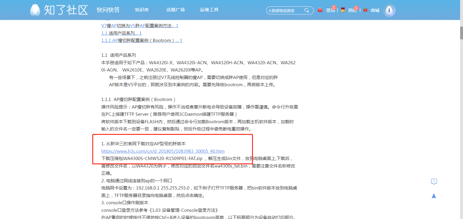

1. 从新华三的官网下载对应AP型号的胖版本
https://www.h3c.com/cn/d_201805/1083983_30005_40.htm
下载压缩包WA4300S-CMW520-R1509P01-FAT.zip ,解压生成bin文件,放到电脑桌面上,下载后,需修改文件名,以WA4320为例子,修改对应的启动文件名wa4300s_fat.bin,需要注意文件名称修改正确。
2. 电脑通过网线连接到ap的一个网口
电脑网卡设置为:192.168.0.1 255.255.255.0,如下例子打开TFTP服务器,把bin软件版本放到电脑桌面上,TFTP服务器目录指向电脑桌面,然后点击确定。

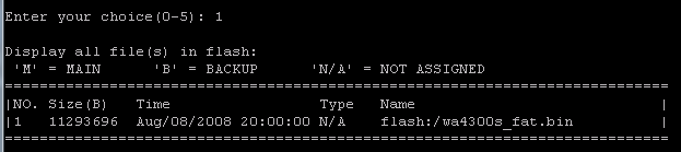

Enter your choice(0-5): 1              //此时为更新bootware版本
Loading.....................................................................
.Done.
11248640 bytes downloaded!

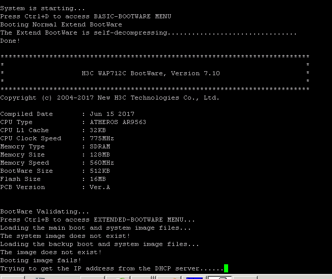

Read net params from bootrom failed, use the default value
BootWare Validating...
Press Ctrl+B to enter extended boot menu...
Starting to get the main application file--flash:/wa4300s_fit.bin!
The main application file does not exist--flash:/wa4300s_fit.bin!
Starting to get the backup application file--flash:/backup.bin!
The backup application file does not exist--flash:/backup.bin!
Starting to get the secure application file--flash:/secure.bin!
The secure application file does not exist--flash:/secure.bin!
Booting App fails!
Trying to get the IP address from the DHCP server......
Getting IP Address Failed, the system will reboot.

|<7> BootWare Operation Menu                                               |
|<8> Clear Super Password                                                  |
|<9> Storage Device Operation                                              |
|<0> Reboot                                                                |
Ctrl+C: Display Copyright
Ctrl+Y: Change AP Mode
Ctrl+F: Format File System
Enter your choice(0-9): 3     //进到以太网子菜单
==========================<Enter Ethernet SubMenu>==========================
|Note:the operating device is flash                                        |
|<1> Download Application Program To SDRAM And Run                         |
|<2> Update Main Application File                                          |
|<3> Modify Ethernet Parameter                                             |
|<0> Exit To Main Menu                                                     |
|<Ensure The Parameter Be Modified Before Downloading!>                    |
Enter your choice(0-3): 3      //更改以太网参数
==========================<ETHERNET PARAMETER SET>==========================
|Note:       '.' = Clear field.                                            |
|            '-' = Go to previous field.                                   |
|          Ctrl+D = Quit.                                                  |
Protocol (FTP or TFTP) :tftp
//忽略输出内容,直接输入TFTP,然后回车
Load File Name         :wa4300s_fat.bin
//忽略输出内容,直接输入wa4300s_fat.bin,然后回车
Target File Name       :wa4300s_fat.bin
Server IP Address      :192.168.0.1
//忽略输出内容,直接输入电脑主机的 IP,如192.168.0.1,然后回车
Local IP Address       :192.168.0.19
//忽略输出内容,直接输入和电脑主机的ip同一网段,比如192.168.0.19,然后回车
Subnet Mask            :255.255.255.0
//忽略输出内容,直接回车
Gateway IP Address     :0.0.0.0
//忽略输出内容,直接回车
Enter your choice(0-3): 2    //更新主应用文件,此时为AP版本文件
.Done!
Updating File flash:/wa4300s_fat.bin........................................
..........................................................Done!
Enter your choice(0-3): 0    //返回主菜单
===========================<EXTEND-BOOTWARE MENU>===========================
|<1> Boot System                                                           |
|<2> Enter Serial SubMenu                                                  |
|<3> Enter Ethernet SubMenu                                                |
|<4> File Control                                                          |
|<5> Restore to Factory Default Configuration                              |
|<6> Skip Current System Configuration                                     |
|<0> Reboot                                                                |
Enter your choice(0-9): 0              //重启
System is starting...
Press Ctrl+D to access BASIC-BOOTWARE MENU
Booting Normal Extend BootWare
The Extend BootWare is self-decompressing.........................Done!
*                H3C WA4320-ACN-C BootWare, Version 1.05                   *
Copyright (c) 2004-2016 Hangzhou H3C Technologies Co., Ltd.
Compiled Date       : Jun 28 2016
CPU Type            : ATHEROS AR9563
CPU L1 Cache        : 32KB
CPU Clock Speed     : 775MHz
Memory Type         : SDRAM
Memory Size         : 128MB
Memory Speed        : 560MHz
BootWare Size       : 512KB
Flash Size          : 16MB
PCB Version         : Ver.B
Starting to get the main application file--flash:/wa4300s_fat.bin!..........
The App file is self-decompressing..........................................
System application is starting...
Startup configuration file does not exist.
User interface con0 is available.
4. 切换成V5胖模式完成。
重启设备完成后就可以使用默认的管理地址192.168.0.50登录AP进行管理了。登录AP的默认用户名是admin,密码是h3capadmin.

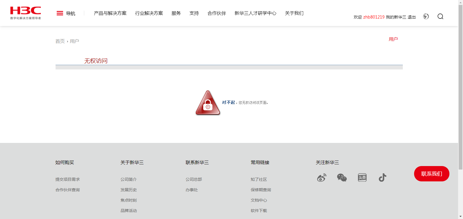

从新华三的官网下载对应AP型号的胖版本的时候提示没有权限,这个要怎么才能下载?
账号yx800 密码01230123
