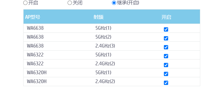

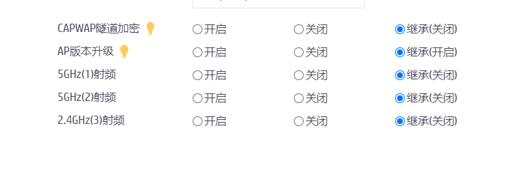

上线了几个ap,当时手动设置了开启射频,过了一个月左右,该ap自己关闭了射频,今天查看的时候发现是继承的状态,我去查看了默认的组的配置,发现默认的都是开启的,应该不存在继承其他的问题吧,目前只有默认组。请问这个是什么问题导致的,该如何解决(主要担心现在手动给他改成开启之后过一段时间又像上次一样出现同样的情况。下图为问题ap:
下图为默认组配置:)

dis cu 发出来看下
大佬,发在下面了

version 7.1.064, Release 5439P03
sysname AC
wlan global-configuration
telnet server enable
irf mac-address persistent timer
irf auto-update enable
irf auto-merge enable
irf member 1 priority 1
password-recovery enable
vlan 1
vlan 20
description client
vlan 30
description AP
vlan 1000
description manage
irf-port 1
wlan service-template 2
ssid NJSTXZXX
vlan 20
akm mode psk
preshared-key pass-phrase cipher $c$3$RKw/JzgH0T8rxiPlushDoFktYSXAWqo6r/al
cipher-suite ccmp
cipher-suite tkip
security-ie rsn
security-ie wpa
service-template enable
interface NULL0
interface Vlan-interface20
description client
ip address 192.168.21.253 255.255.254.0
interface Vlan-interface30
description AP
ip address 192.168.30.253 255.255.255.0
interface Vlan-interface1000
description manage
ip address 192.168.0.253 255.255.255.0
port link-type trunk
port trunk permit vlan all
interface GigabitEthernet1/0/4
interface GigabitEthernet1/0/5
interface GigabitEthernet1/0/6
interface GigabitEthernet1/0/7
interface GigabitEthernet1/0/8
port access vlan 1000
scheduler logfile size 16
line class console
user-role network-admin
line class vty
user-role network-operator
line con 0
line vty 0 31
authentication-mode scheme
ip route-static 0.0.0.0 0 192.168.0.254
undo info-center enable
undo info-center logfile enable
domain system
domain default enable system
role name level-0
description Predefined level-0 role
role name level-1
description Predefined level-1 role
role name level-2
description Predefined level-2 role
role name level-3
description Predefined level-3 role
role name level-4
description Predefined level-4 role
role name level-5
description Predefined level-5 role
role name level-6
description Predefined level-6 role
role name level-7
description Predefined level-7 role
role name level-8
description Predefined level-8 role
role name level-9
description Predefined level-9 role
role name level-10
description Predefined level-10 role
role name level-11
description Predefined level-11 role
role name level-12
description Predefined level-12 role
role name level-13
description Predefined level-13 role
role name level-14
description Predefined level-14 role
user-group system
local-user admin class manage
password hash $h$6$UJ4wXfuXYyAl6PK3$HWDvXIHkfIKoUJHMRMxKW+fxdcVNynZ4MPT44YNrsfiBilDW8FNL0aUwxHdPx109uiFpylj74Vh1DXVm999U0Q==
service-type telnet http https
authorization-attribute user-role level-15
authorization-attribute user-role network-admin
ip http enable
ip https enable
wlan auto-ap enable
wlan auto-persistent enable
wlan ap-group default-group
vlan 1
ap-model WA6320H
radio 1
radio enable
service-template 2
radio 2
radio enable
service-template 2
gigabitethernet 1
gigabitethernet 2
gigabitethernet 3
gigabitethernet 4
gigabitethernet 5
ap-model WA6322
radio 1
radio enable
service-template 2
radio 2
radio enable
service-template 2
gigabitethernet 1
gigabitethernet 2
gigabitethernet 3
ap-model WA6638
radio 1
radio enable
service-template 2
radio 2
radio enable
service-template 2
radio 3
radio enable
service-template 2
gigabitethernet 1
ten-gigabitethernet 1
wlan ap 00be-d54e-5700 model WA6322
serial-id 219801A23U8207P003DZ
vlan 1
radio 1
radio enable
service-template 2
radio 2
service-template 2
gigabitethernet 1
gigabitethernet 2
gigabitethernet 3
wlan ap 00be-d54e-9460 model WA6322
serial-id 219801A23U8207P003XT
vlan 1
radio 1
radio enable
service-template 2
radio 2
radio enable
service-template 2
gigabitethernet 1
gigabitethernet 2
gigabitethernet 3
wlan ap 00be-d54e-9680 model WA6322
serial-id 219801A23U8207P003YC
vlan 1
radio 1
radio enable
service-template 2
radio 2
radio enable
service-template 2
gigabitethernet 1
gigabitethernet 2
gigabitethernet 3
wlan ap 00be-d54e-5da0 model WA6322
serial-id 219801A23U8207P003GP
vlan 1
radio 1
radio enable
service-template 2
radio 2
radio enable
service-template 2
gigabitethernet 1
gigabitethernet 2
gigabitethernet 3
wlan ap 00be-d54e-5e80 model WA6322
serial-id 219801A23U8207P003GX
vlan 1
radio 1
radio enable
service-template 2
radio 2
radio enable
service-template 2
gigabitethernet 1
gigabitethernet 2
gigabitethernet 3
wlan ap 00be-d54e-6a80 model WA6322
serial-id 219801A23U8207P003L0
vlan 1
radio 1
radio enable
service-template 2
radio 2
radio enable
service-template 2
gigabitethernet 1
gigabitethernet 2
gigabitethernet 3
wlan ap 00be-d54e-77c0 model WA6322
serial-id 219801A23U8207P003PF
vlan 1
radio 1
radio enable
service-template 2
radio 2
radio enable
service-template 2
gigabitethernet 1
gigabitethernet 2
gigabitethernet 3
wlan ap 00be-d54e-7c20 model WA6322
serial-id 219801A23U8207P003QK
vlan 1
radio 1
radio enable
service-template 2
radio 2
radio enable
service-template 2
gigabitethernet 1
gigabitethernet 2
gigabitethernet 3
wlan ap 00be-d54e-9ae0 model WA6322
serial-id 219801A23U8207P003ZH
vlan 1
radio 1
radio enable
service-template 2
radio 2
radio enable
service-template 2
gigabitethernet 1
gigabitethernet 2
gigabitethernet 3
wlan ap 00be-d54e-9b20 model WA6322
serial-id 219801A23U8207P003ZK
vlan 1
radio 1
radio enable
service-template 2
radio 2
radio enable
service-template 2
gigabitethernet 1
gigabitethernet 2
gigabitethernet 3
wlan ap 00be-d54e-a560 model WA6322
serial-id 219801A23U8207P00426
vlan 1
radio 1
radio enable
service-template 2
radio 2
radio enable
service-template 2
gigabitethernet 1
gigabitethernet 2
gigabitethernet 3
wlan ap 00be-d54e-aac0 model WA6322
serial-id 219801A23U8207P0043L
vlan 1
radio 1
radio enable
service-template 2
radio 2
radio enable
service-template 2
gigabitethernet 1
gigabitethernet 2
gigabitethernet 3
wlan ap 00be-d54e-ac20 model WA6322
serial-id 219801A23U8207P0043Y
vlan 1
radio 1
radio enable
service-template 2
radio 2
radio enable
service-template 2
gigabitethernet 1
gigabitethernet 2
gigabitethernet 3
wlan ap 2-3F-bangongshi model WA6320
serial-id 219801A28N8218E00203
vlan 1
radio 1
radio 2
gigabitethernet 1
wlan ap 2-4F-bangongshi model WA6320
serial-id 219801A28N8218E001Z8
vlan 1
radio 1
radio 2
gigabitethernet 1
wlan ap 3-2F-bangongshi model WA6320
serial-id 219801A28N8218E00213
vlan 1
radio 1
radio 2
gigabitethernet 1
wlan ap 3-3F-bangongshi model WA6320
serial-id 219801A28N8218E001TZ
vlan 1
radio 1
radio 2
gigabitethernet 1
wlan ap 3-4F-bangongshi model WA6320
serial-id 219801A28N8218E001W1
vlan 1
radio 1
radio 2
gigabitethernet 1
wlan ap 3-5F-bangongshi model WA6320
serial-id 219801A28N8218E001Y7
vlan 1
radio 1
radio 2
gigabitethernet 1
wlan ap 6893-2084-3000 model WA6320H
serial-id 219801A2978207E003TW
vlan 1
radio 1
radio 2
gigabitethernet 1
gigabitethernet 2
gigabitethernet 3
gigabitethernet 4
gigabitethernet 5
wlan ap 6893-2085-09a0 model WA6320H
serial-id 219801A2978207E005N1
vlan 1
radio 1
radio 2
gigabitethernet 1
gigabitethernet 2
gigabitethernet 3
gigabitethernet 4
gigabitethernet 5
wlan ap 6893-2085-1c40 model WA6320H
serial-id 219801A2978207E005SV
vlan 1
radio 1
radio 2
gigabitethernet 1
gigabitethernet 2
gigabitethernet 3
gigabitethernet 4
gigabitethernet 5
wlan ap 6893-2085-1f80 model WA6320H
serial-id 219801A2978207E005TP
vlan 1
radio 1
radio 2
gigabitethernet 1
gigabitethernet 2
gigabitethernet 3
gigabitethernet 4
gigabitethernet 5
wlan ap 6893-2085-2aa0 model WA6320H
serial-id 219801A2978207E005XK
vlan 1
radio 1
radio 2
gigabitethernet 1
gigabitethernet 2
gigabitethernet 3
gigabitethernet 4
gigabitethernet 5
wlan ap 6893-2086-7650 model WA6638
serial-id 219801A24F8207E000F7
vlan 1
radio 1
radio 2
radio 3
gigabitethernet 1
wlan ap 6893-2086-71d0 model WA6638
serial-id 219801A24F8207E000DG
vlan 1
radio 1
radio 2
radio 3
gigabitethernet 1
wlan ap 6893-2086-72f0 model WA6638
serial-id 219801A24F8207E000DN
vlan 1
radio 1
radio 2
radio 3
gigabitethernet 1
wlan ap 7450-4e1f-9040 model WA6338
serial-id 219801A2DQ820CE000TN
vlan 1
radio 1
radio enable
radio 2
radio enable
radio 3
radio enable
gigabitethernet 1
smartrate-ethernet 1
wlan ap 7450-4e1f-8a10 model WA6338
serial-id 219801A2DQ820CE000SL
vlan 1
radio 1
radio 2
radio 3
gigabitethernet 1
wlan ap 7450-4e1f-8b90 model WA6338
serial-id 219801A2DQ820CE000SV
vlan 1
radio 1
radio 2
radio 3
gigabitethernet 1
wlan ap 7450-4e20-3240 model WA6338
serial-id 219801A2DQ820CE001QJ
vlan 1
radio 1
radio enable
radio 2
radio enable
radio 3
radio enable
gigabitethernet 1
wlan ap 7450-4e20-2cd0 model WA6338
serial-id 219801A2DQ820CE001PL
vlan 1
radio 1
radio 2
radio 3
gigabitethernet 1
wlan ap 7450-4e20-32d0 model WA6338
serial-id 219801A2DQ820CE001QM
vlan 1
radio 1
radio enable
radio 2
radio enable
radio 3
radio enable
gigabitethernet 1
return

除了默认的组,有没有添加过其他的组,检查一下
