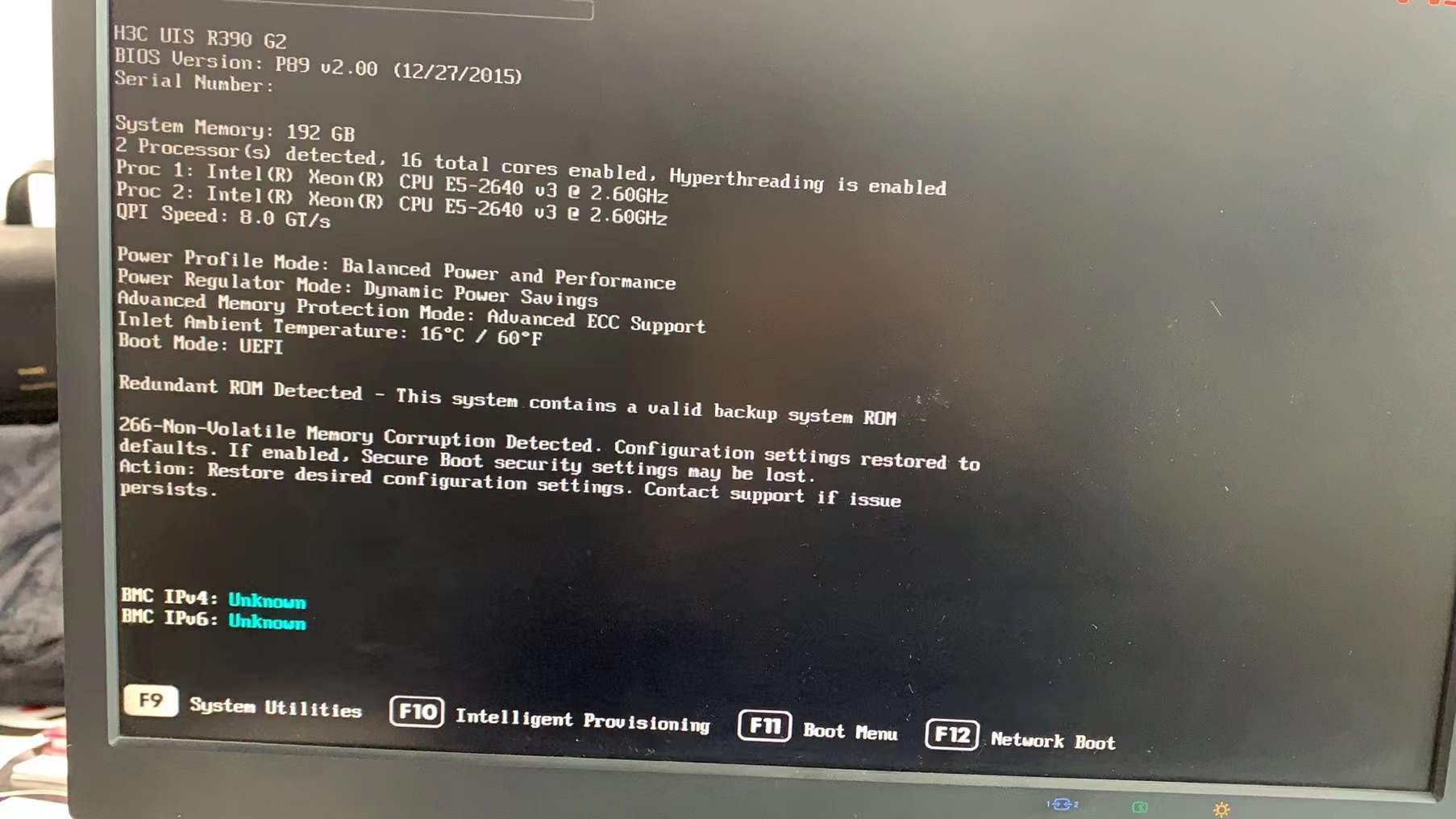

R390 G2服务器开机进不了bios系统

如图所示,R390 G2服务器开机一直卡在这个界面,无法进入系统

Symptom
266-Non-Volatile Memory Corruption Detected. Configuration settings restored to defaults. If enabled, Secure Boot security settings may be lost.
Cause
server was interrupted while writing to NVRAM by one of the following:
一台服务器在向NVRAM写入时被下列情况之一打断。
  • A sudden removal of power
  • Pressing the power button
  • Pressing the iLO virtual power button
Action
  1. Reset any configuration settings that differ from the default settings.重置任何与默认设置不同的配置设置。
新添加了NV内存?
