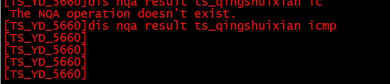

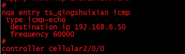

H3C路由器5660设备,配置了NQA,但是检测不到结果,请问大神,这样配置对吗
是不是还有个start now
粉丝:11人 关注:1人
参考一下我这个配置案例
track 1 nqa entry 1 1 reaction 1
nqa entry 1 1
type icmp-echo
destination ip 114.114.114.114
frequency 1000
history-record enable
history-record number 15
probe count 15
probe timeout 800
reaction 1 checked-element probe-fail threshold-type consecutive 5 action-type trigger-only
source interface Eth-channel1/0:0
nqa schedule 1 1 start-time now lifetime forever

nqa schedule ??? ??? start-time now lifetime forever
谢谢,可以了
