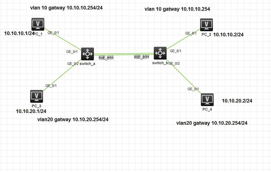

在HCL 3.0.1 模拟器上,配置基于IP子网的vlan,相同子网可以ping,不同子网不能ping。目前有的刚好是需要这样的网络拓扑结构。
网络拓扑如下图。

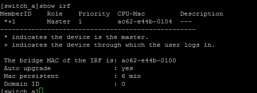

交换机a的配置内容:
version 7.1.075, Alpha 7571
sysname switch_a
irf mac-address persistent timer
irf auto-update enable
undo irf link-delay
irf member 1 priority 1
lldp global enable
system-working-mode standard
xbar load-single
password-recovery enable
lpu-type f-series
vlan 1
vlan 10
ip-subnet-vlan 0 ip 10.10.10.0 255.255.255.0
vlan 20
ip-subnet-vlan 0 ip 10.10.20.0 255.255.255.0
stp global enable
interface Bridge-Aggregation1
port link-type trunk
port trunk permit vlan all
interface NULL0
interface Vlan-interface10
ip address 10.10.10.254 255.255.255.0
interface Vlan-interface20
ip address 10.10.20.254 255.255.255.0
interface FortyGigE1/0/53
port link-mode bridge
interface FortyGigE1/0/54
port link-type hybrid
port hybrid vlan 1 10 20 untagged
port hybrid ip-subnet-vlan vlan 10
port hybrid ip-subnet-vlan vlan 20
combo enable fiber
combo enable fiber
combo enable fiber
interface GigabitEthernet1/0/4
combo enable fiber
interface GigabitEthernet1/0/5
combo enable fiber
interface GigabitEthernet1/0/6
combo enable fiber
interface GigabitEthernet1/0/7
combo enable fiber
interface GigabitEthernet1/0/8
combo enable fiber
interface GigabitEthernet1/0/9
combo enable fiber
interface GigabitEthernet1/0/10
combo enable fiber
interface GigabitEthernet1/0/11
combo enable fiber
interface GigabitEthernet1/0/12
combo enable fiber
interface GigabitEthernet1/0/13
combo enable fiber
interface GigabitEthernet1/0/14
combo enable fiber
interface GigabitEthernet1/0/15
combo enable fiber
interface GigabitEthernet1/0/16
combo enable fiber
interface GigabitEthernet1/0/17
combo enable fiber
interface GigabitEthernet1/0/18
combo enable fiber
interface GigabitEthernet1/0/19
combo enable fiber
interface GigabitEthernet1/0/20
combo enable fiber
interface GigabitEthernet1/0/21
combo enable fiber
interface GigabitEthernet1/0/22
combo enable fiber
interface GigabitEthernet1/0/23
combo enable fiber
interface GigabitEthernet1/0/24
combo enable fiber
interface GigabitEthernet1/0/25
combo enable fiber
interface GigabitEthernet1/0/26
combo enable fiber
interface GigabitEthernet1/0/27
combo enable fiber
interface GigabitEthernet1/0/28
combo enable fiber
interface GigabitEthernet1/0/29
combo enable fiber
interface GigabitEthernet1/0/30
combo enable fiber
interface GigabitEthernet1/0/31
combo enable fiber
interface GigabitEthernet1/0/32
combo enable fiber
interface GigabitEthernet1/0/33
combo enable fiber
interface GigabitEthernet1/0/34
combo enable fiber
interface GigabitEthernet1/0/35
combo enable fiber
interface GigabitEthernet1/0/36
combo enable fiber
interface GigabitEthernet1/0/37
combo enable fiber
interface GigabitEthernet1/0/38
combo enable fiber
interface GigabitEthernet1/0/39
combo enable fiber
interface GigabitEthernet1/0/40
combo enable fiber
interface GigabitEthernet1/0/41
combo enable fiber
interface GigabitEthernet1/0/42
combo enable fiber
interface GigabitEthernet1/0/43
combo enable fiber
interface GigabitEthernet1/0/44
combo enable fiber
interface GigabitEthernet1/0/45
combo enable fiber
interface GigabitEthernet1/0/46
combo enable fiber
interface GigabitEthernet1/0/47
combo enable fiber
interface GigabitEthernet1/0/48
combo enable fiber
interface M-GigabitEthernet0/0/0
interface Ten-GigabitEthernet1/0/49
combo enable fiber
interface Ten-GigabitEthernet1/0/50
combo enable fiber
port link-aggregation group 1
interface Ten-GigabitEthernet1/0/51
combo enable fiber
interface Ten-GigabitEthernet1/0/52
combo enable fiber
scheduler logfile size 16
line class aux
user-role network-operator
line class console
user-role network-admin
line class tty
line class vty
line aux 0
line con 0
line vty 0 63
radius scheme system
user-name-format without-domain
domain name system
domain default enable system
role name level-0
description Predefined level-0 role
role name level-1
description Predefined level-1 role
role name level-2
description Predefined level-2 role
role name level-3
description Predefined level-3 role
role name level-4
description Predefined level-4 role
role name level-5
description Predefined level-5 role
role name level-6
description Predefined level-6 role
role name level-7
description Predefined level-7 role
role name level-8
description Predefined level-8 role
role name level-9
description Predefined level-9 role
role name level-10
description Predefined level-10 role
role name level-11
description Predefined level-11 role
role name level-12
description Predefined level-12 role
role name level-13
description Predefined level-13 role
role name level-14
description Predefined level-14 role
user-group system
return

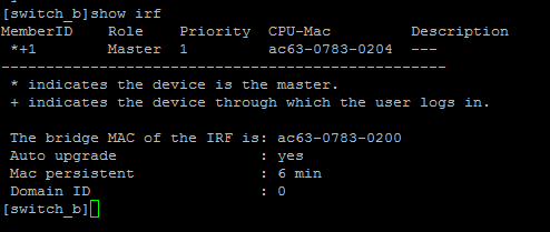

交换机b的配置内容:
sysname switch_b
undo irf link-delay
lldp global enable
xbar load-single
lpu-type f-series
vlan 1
vlan 10
vlan 20
stp global enable
interface NULL0
combo enable fiber
combo enable fiber
combo enable fiber
combo enable fiber
combo enable fiber
combo enable fiber
combo enable fiber
combo enable fiber
combo enable fiber
combo enable fiber
combo enable fiber
combo enable fiber
combo enable fiber
combo enable fiber
combo enable fiber
combo enable fiber
combo enable fiber
combo enable fiber
combo enable fiber
combo enable fiber
combo enable fiber
combo enable fiber
combo enable fiber
combo enable fiber
combo enable fiber
combo enable fiber
combo enable fiber
combo enable fiber
combo enable fiber
combo enable fiber
combo enable fiber
combo enable fiber
combo enable fiber
combo enable fiber
combo enable fiber

兄弟,你的这套配置我检查过了,你配置的没有问题。
1 此配置和irf没有关系。
2你可以检查下两台设备的mac地址表(dis mac-address
),你就可以发现10网段的mac都被和vlan1绑定了,20的mac也被vlan1绑定了,这是不合常规,正常情况应该是分别绑定vlan10和vlan20.
3你也可以抓包来看,你抓交换机之间线缆的数据包,你可以发现即使10网段互通,他数据帧中也没有vlan10的标签,所以证明了10网段的数据包进交换机之后根本没有打标签的操作。
实际上HCL只支持基于子网vlan的配置,但是不支持运行。不过你的配置没问题,有时间用真机跑一跑。请采纳。

确认堆叠状态正常吗,display irf看一下,如果堆叠状态正常,网关都在这两天IRF设备上,是可以互访的
zhiliao_11J3A8 知了小白
@zhiliao_o6nROK
switch_a的
swithch_b的
这个就没堆叠成功,检查下IRF配置吧,参考一下官网案例
zhiliao_o6nROK 发表时间:2021-12-30 更多>>
