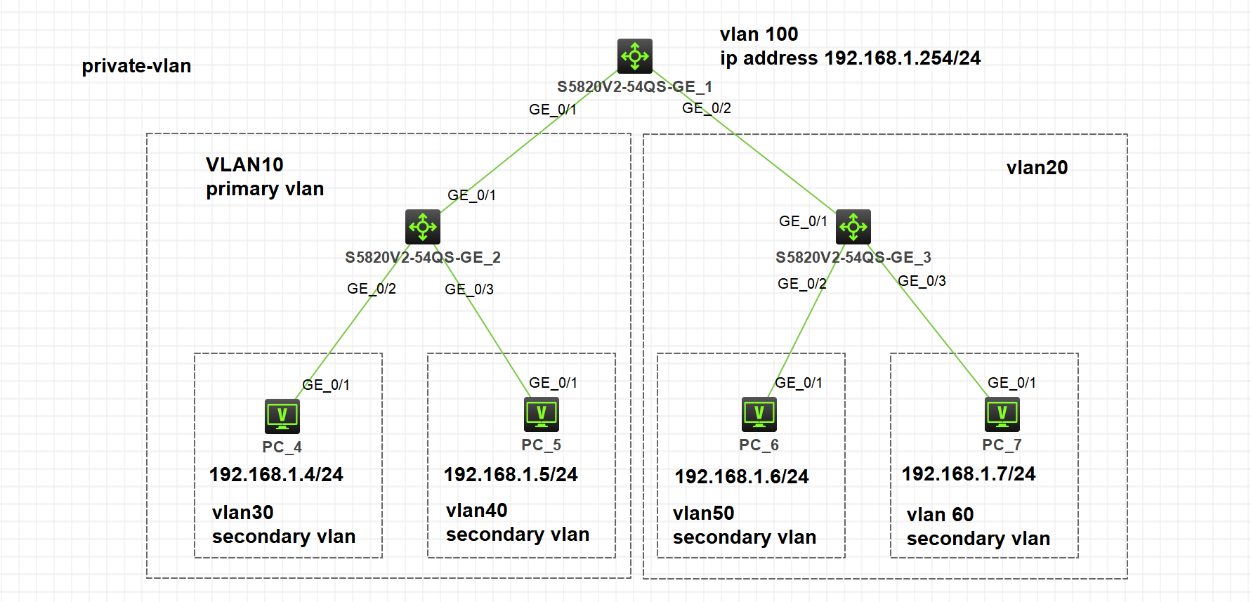

配置private vlan时,交换机一直进行LLDP提示。
sw1:
%Jan 5 12:20:06:570 2022 sw1 LLDP/5/LLDP_PVID_INCONSISTENT: PVID mismatch discovered on GigabitEthernet1/0/1 (PVID 100), with sw2 GigabitEthernet1/0/1 (PVID 10). %Jan 5 12:20:33:385 2022 sw1 LLDP/5/LLDP_PVID_INCONSISTENT: PVID mismatch discovered on GigabitEthernet1/0/2 (PVID 100), with H3C GigabitEthernet1/0/1 (PVID 20).
sw2:
%Jan 5 11:27:05:021 2022 sw2 LLDP/5/LLDP_PVID_INCONSISTENT: PVID mismatch discovered on GigabitEthernet1/0/1 (PVID 10), with sw1 GigabitEthernet1/0/1 (PVID 1).
sw3:
%Jan 5 12:15:49:188 2022 H3C LLDP/5/LLDP_PVID_INCONSISTENT: PVID mismatch discovered on GigabitEthernet1/0/1 (PVID 20), with sw1 GigabitEthernet1/0/2 (PVID 100).
粉丝:114人 关注:1人
可以关闭LLDP检查PVID不一致的功能
lldp ignore-pvid-inconsistency
非常感谢,已解决。
