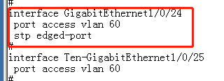

# 配置端口GigabitEthernet1/0/1为边缘端口。
<Sysname> system-view
[Sysname] interface gigabitethernet 1/0/1
[Sysname-GigabitEthernet1/0/1] stp edged-port
