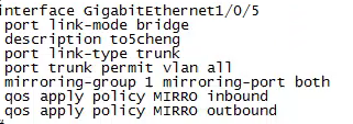

%Jan 18 19:22:54:619 2016 gygaj02 QOS/4/QOS_POLICY_APPLYIF_CBFAIL: Failed to apply classifier-behavior MIRRO in policy MIRRO to the outbound direction of interface GigabitEthernet1/0/24. The operation is not supported.
24口即做本地镜像,又做流镜像,inbound无报错,out报错如上:

The operation is not supported.   不支持
但是接口下命令是能敲上去的

5口配置和24口一致
