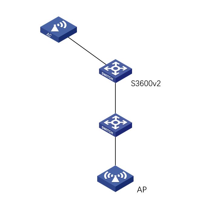

S3600v2交换机trunk接口下接一台非网管二层交换机,在非网管交换机上接了3个AP其中两个AP正常,一个AP无法正常上线,问题AP的mac地址在3600上看不到,但把该ap接到3600其他同配置接口上可以正常使用。
S3600v2上查看日志:
%Jan 24 16:08:11:247 2022 QS_INT_S3600_2LOU LLDP/5/LLDP_NEIGHBOR_AGE_OUT: Neighbor aged out on Port Ethernet1/0/13 (IfIndex 9371660), Chassis ID is 4ce9-e409-ef20, Port ID is GigabitEthernet1/0/1. %Jan 24 16:05:10:862 2022 QS_INT_S3600_2LOU LLDP/6/LLDP_CREATE_NEIGHBOR: New neighbor created on Port Ethernet1/0/13 (IfIndex 9371660), Chassis ID is 4ce9-e409-ef20, Port ID is GigabitEthernet1/0/1. %Jan 24 15:52:04:102 2022 QS_INT_S3600_2LOU LLDP/5/LLDP_NEIGHBOR_AGE_OUT: Neighbor aged out on Port Ethernet1/0/13 (IfIndex 9371660), Chassis ID is 4ce9-e409-ef20, Port ID is GigabitEthernet1/0/1. %Jan 24 15:42:33:191 2022 QS_INT_S3600_2LOU LLDP/6/LLDP_CREATE_NEIGHBOR: New neighbor created on Port Ethernet1/0/13 (IfIndex 9371660), Chassis ID is 4ce9-e409-ef20, Port ID is GigabitEthernet1/0/1.
mac发现后3分钟不到就老化了,请问这是什么问题。

看着像是无管理交换机的问题
粉丝:11人 关注:0人
查ap问题,需要console线接到ap上查看上线情况。交换机层面看不出问题的,电脑接到ap的那个线看下是否可以获取到地址,看下线是否8芯都正常
估计供电不足
