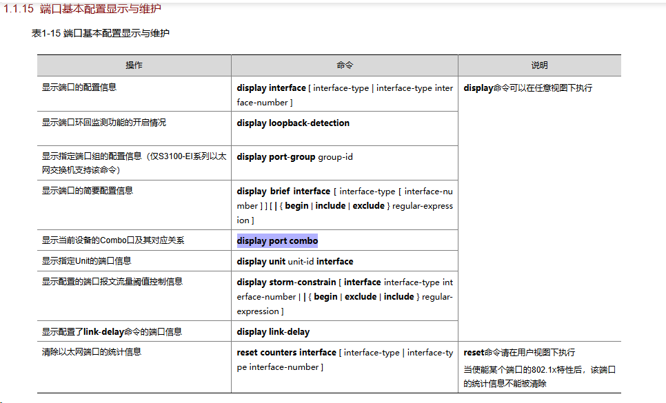

zhiliao_gc14rO 知了小白
display port combo
