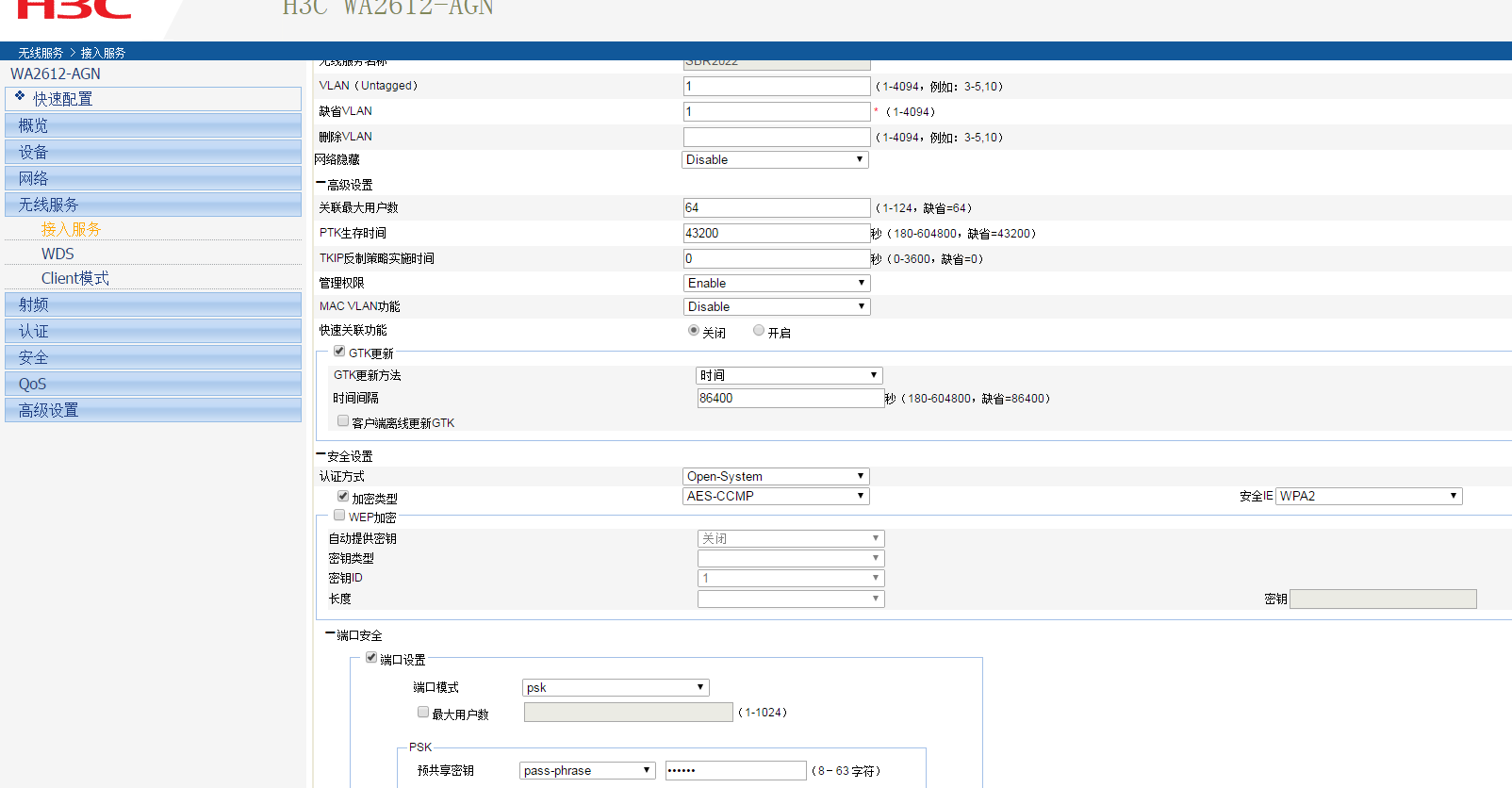

WA2612刷了胖ap固件,从web管理界面快速配置好ap热点,密码是8个0,手机和电脑连接时提示密码错误,
无线服务名称 VLAN(Untagged) (1-4094,例如:3-5,10) 缺省VLAN  * (1-4094) 删除VLAN (1-4094,例如:3-5,10) 网络隐藏 Enable Disable +高级设置 -安全设置 认证方式 Open-System   加密类型  AES-CCMP  WEP加密自动提供密钥 关闭 密钥类型 密钥ID   长度 密钥 -端口安全 端口设置  端口模式 psk   最大用户数 (1-1024)   PSK 预共享密钥 pass-phrase (8个0)   这里好像不能传图片

目前的设置参数
目前配置文件如下,我再试试不加密的热点
 # version 5.20, Release 1308P11 # sysname WA2612-AGN # clock timezone UTC add 00:00:00 # domain default enable system # telnet server enable # port-security enable # password-recovery enable # vlan 1 # domain system access-limit disable state active idle-cut disable self-service-url disable # user-group system group-attribute allow-guest # local-user admin password cipher $c$3$6tSpAMAe2g2eYEx7+4oOmeYQlR2bO6u1cJH9qY0= authorization-attribute level 3 service-type telnet service-type web # wlan rrm dot11a mandatory-rate 6 12 24 dot11a supported-rate 9 18 36 48 54 dot11b mandatory-rate 1 2 dot11b supported-rate 5.5 11 dot11g mandatory-rate 1 2 5.5 11 dot11g supported-rate 6 9 12 18 24 36 48 54 # wlan service-template 1 clear ssid H3C service-template enable # wlan service-template 2 crypto ssid SBR2022 cipher-suite ccmp security-ie rsn service-template enable # cwmp undo cwmp enable # interface NULL0 # interface Vlan-interface1 ip address 192.168.10.50 255.255.255.0 # interface GigabitEthernet1/0/1 # interface WLAN-BSS32 port link-type hybrid port hybrid vlan 1 untagged # interface WLAN-BSS33 port link-type hybrid port hybrid vlan 1 untagged port-security port-mode psk port-security tx-key-type 11key port-security preshared-key pass-phrase cipher $c$3$Z1zIrkz90lRdPADqe7perTM2dcScDzJS0IfZ # interface WLAN-Radio1/0/1 radio-type dot11an service-template 2 interface wlan-bss 33 # ip route-static 0.0.0.0 0.0.0.0 192.168.10.1 # arp-snooping enable # load xml-configuration # load tr069-configuration # user-interface con 0 user-interface vty 0 4 authentication-mode scheme # return

贴个配置看看,应该是设置问题。可以发一个不加密的无线测试,看是否可以正常连接
把端口安全去掉试下,配置看是正常的。无法获取到地址,你让地址从主路由分配,我看你wlan-bss默认vlan1的,接口下也没有放通对应的vlan

用没密码的可以连接,但又发现另一个问题,主路由没有给电脑和手机分配ip,手动设置ip后可以正常连接,AP里开启dhcp后也不分配ip,但电脑可以通过局域网远程进入AP的管理页面,说明AP和主路由是联通的(AP插网线,配置的时候是直接连接电脑的)
zhiliao_ODtoEU 发表时间:2022-02-16
