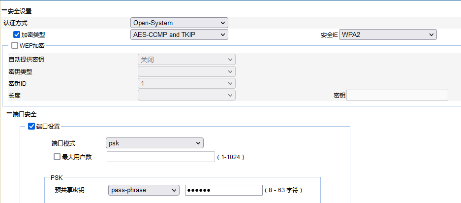

WA2620-AGN wifi密码明明输入正确,但手机总是显示:密码错误,连接失败
2022-02-22提问
  • 1收藏,3741浏览
不管是WEB端(见图)还是CON口改密,都可以正常改密,但手机连接WIFI时就会提示:密码错误,连接失败
下面是COM1改密的命令行。
[WA2620-AGN]interface WLAN-BSS1
[WA2620-AGN-WLAN-BSS1]port-security preshared-key pass-phrase s 123456789
下面是手机联WIFI是COM1的提示:
%Feb 22 16:48:38:519 2022 WA2620-AGN WMAC/6/WMAC_CLIENT_JOIN_WLAN: Client a2cb-7bd4-56c7 successfully joins WLAN TD-5G, on APID 1 with BSSID 3822-d68b-2080. %Feb 22 16:48:38:519 2022 WA2620-AGN IFNET/3/LINK_UPDOWN: WLAN-BSS34 link status is UP. %Feb 22 16:48:47:343 2022 WA2620-AGN WMAC/6/WMAC_CLIENT_GOES_OFFLINE: Client a2cb-7bd4-56c7 disconnected from WLAN TD-5G. Reason code is 15. %Feb 22 16:48:47:343 2022 WA2620-AGN IFNET/3/LINK_UPDOWN: WLAN-BSS34 link status is DOWN. %Feb 22 16:48:48:249 2022 WA2620-AGN PORTSEC/5/PORTSEC_VIOLATION: -IfName=WLAN-BSS34-MACAddr=A2:CB:7B:D4:56:C7-VlanId=-1-IfStatus=Down; Intrusion detected.
