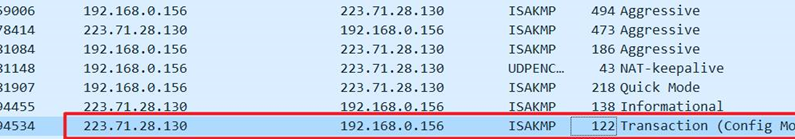

debug来看正是在config mode中找不到期望的属性值,才将ike sa删除了,查看报文也是对端的config_mode报文导致;若对端是发出来报文且携带正确属性,那建议排查下公网情况和沿途设备。
*Feb 26 19:41:55:534 2022 H3C IKE/7/PACKET: -COntext=1; vrf = 0, local = 192.168.0.156, remote = 223.71.28.130/4500
Checking attributes in mode configuration request message.
*Feb 26 19:41:55:534 2022 H3C IKE/7/ERROR: -COntext=1; vrf = 0, local = 192.168.0.156, remote = 223.71.28.130/4500
No expect attributes in the mode configuration request message.
Failed to negotiate IKE SA.
为什么会出现config_mode的报文
