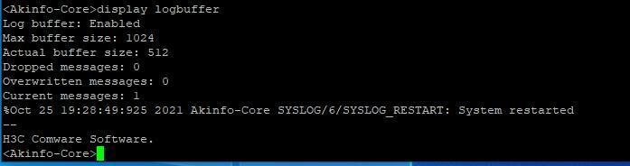

由于断网,想排查看一下交换机日志信息,为啥看不了
粉丝:15人 关注:0人
看看info-center的配置,是不是把部分日志关掉了
info-center被关了,肯定没日志了
Innovation 发表时间:2022-03-21 更多>>
<Akinfo-Core>dis info-center Information Center: Disabled Console: Enabled Monitor: Enabled Log host: Enabled 10.144.111.90, port number: 514, DSCP value:0, host facility: local7 Log buffer: Enabled Max buffer size 1024, current buffer size 512 Current messages 1, dropped messages 0, overwritten messages 0 Log file: Enabled Security log file: Disabled Information timestamp format: Log host: Date Other output destination: Date
zhiliao_aL6PSf 发表时间:2022-03-21
