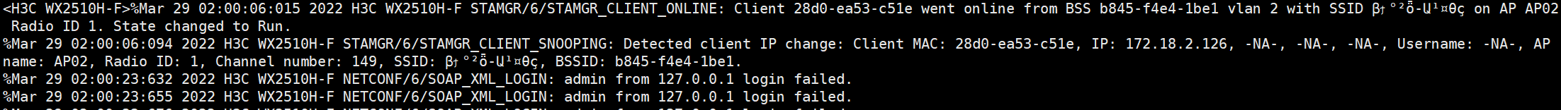

*Mar 29 10:45:49:432 2022 H3C WX2510H-F PORTAL/7/FSM: Auth-SM [172.18.2.126]: Entered state Authenticating. *Mar 29 10:45:49:433 2022 H3C WX2510H-F PORTAL/7/FSM: User-SM[172.18.2.126]: Begin to run. *Mar 29 10:45:49:433 2022 H3C WX2510H-F PORTAL/7/FSM: User-SM [172.18.2.126]: State changed from Initial to Authenticating. *Mar 29 10:45:49:433 2022 H3C WX2510H-F PORTAL/7/FSM: User-SM [172.18.2.126]: State changed from Authenticating to Done. *Mar 29 10:45:49:433 2022 H3C WX2510H-F PORTAL/7/FSM: User-SM[172.18.2.126]: User was destroyed. *Mar 29 10:45:57:118 2022 H3C WX2510H-F PORTAL/7/FSM: Auth-SM: Started to run. *Mar 29 10:45:57:118 2022 H3C WX2510H-F PORTAL/7/FSM: Auth-SM [172.18.2.126]: Entered state Authenticating. *Mar 29 10:45:57:119 2022 H3C WX2510H-F PORTAL/7/FSM: User-SM[172.18.2.126]: Begin to run. *Mar 29 10:45:57:119 2022 H3C WX2510H-F PORTAL/7/FSM: User-SM [172.18.2.126]: State changed from Initial to Authenticating. *Mar 29 10:45:57:119 2022 H3C WX2510H-F PORTAL/7/FSM: User-SM [172.18.2.126]: State changed from Authenticating to Done. *Mar 29 10:45:57:119 2022 H3C WX2510H-F PORTAL/7/FSM: User-SM[172.18.2.126]: User was destroyed. %Mar 29 10:46:26:539 2022 H3C WX2510H-F STAMGR/6/STAMGR_CLIENT_OFFLINE: Client 28d0-ea53-c51e went offline from BSS b845-f4e4-1be1 with SSID β?°??-??¤θ? on AP AP02 Radio ID 1. State changed to Unauth. Reason: Received deauthentication frame in Run state: reason code=1 %Mar 29 10:46:39:765 2022 H3C WX2510H-F STAMGR/6/STAMGR_CLIENT_ONLINE: Client a450-46db-3c03 went online from BSS 00be-d575-b0e1 vlan 2 with SSID β?°??-?????n AP AP01 Radio ID 1. State changed to Run. %Mar 29 10:46:39:767 2022 H3C WX2510H-F STAMGR/6/STAMGR_ROAM_SUCCESS: Client a450-46db-3c03 roamed from BSSID b845-f4e4-1be0 on AP AP02 Radio ID 1 of AC IP 127.0.0.1 to BSSID 00be-d575-b0e1 on AP AP01 Radio ID 1 of AC IP 127.0.0.1 successfully. %Mar 29 10:46:39:768 2022 H3C WX2510H-F STAMGR/6/STAMGR_CLIENT_OFFLINE: Client a450-46db-3c03 went offline from BSS b845-f4e4-1be0 with SSID β?°??-?????n AP AP02 Radio ID 1. State changed to Unauth. Reason: Successfully roamed to another BSS. %Mar 29 10:46:39:769 2022 H3C WX2510H-F STAMGR/6/STAMGR_CLIENT_SNOOPING: Detected client IP change: Client MAC: a450-46db-3c03, IP: 172.18.2.13, -NA-, -NA-, -NA-, Username: -NA-, AP name: AP01, Radio ID: 1, Channel number: 52, SSID: β?°??-?????BSSID: 00be-d575-b0e1.

是否还有其它相关认证报错日志,目前只看到你的认证失败了,你开下debug看看里面具体的信息,是发送失败了还是只是校验失败了,认证信息发送失败说明和AD域对接有问题,检查到AD域连通性,如果校验失败了看下相关的认证对接信息以及AD域上账号是否正常
debugging ldap all debugging portal all 都开启了
留言 发表时间:2022-03-29 更多>>
留言 发表时间:2022-03-29

要具体看对应的认证方式,截图日志中没有明确失败说明,先在认证服务器侧看看有没有什么认证失败的报错
debugging ldap all 开启只看到这个日志
留言 发表时间:2022-03-29
留言 知了小白
<H3C WX2510H-F>%Mar 29 10:24:38:532 2022 H3C WX2510H-F STAMGR/6/STAMGR_CLIENT_OFFLINE: Client a87e-eac0-562f went offline from BSS b845-f4e4-1960 with SSID βϯ°²ȫ-·ÿ΍󥟯n AP AP04 Radio ID 1. State changed to Unauth. Reason: Received deauthentication frame in Run state: reason code=1
