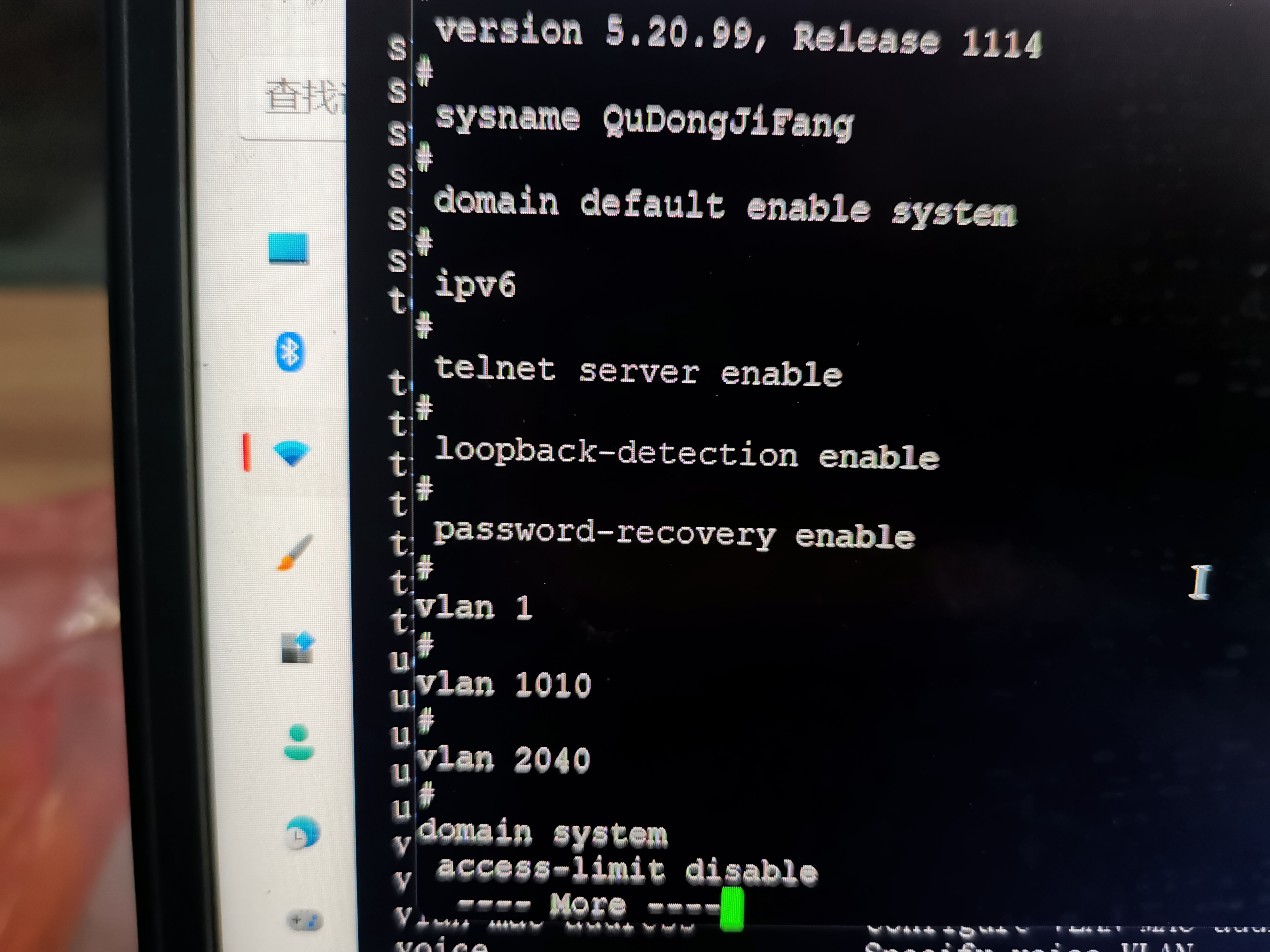

1口和3口是同一根线的两端,这个配置应该是关闭端口,是不是我配置写的不对
我想实现端口检测到环路就自动关闭端口,不用自动打开

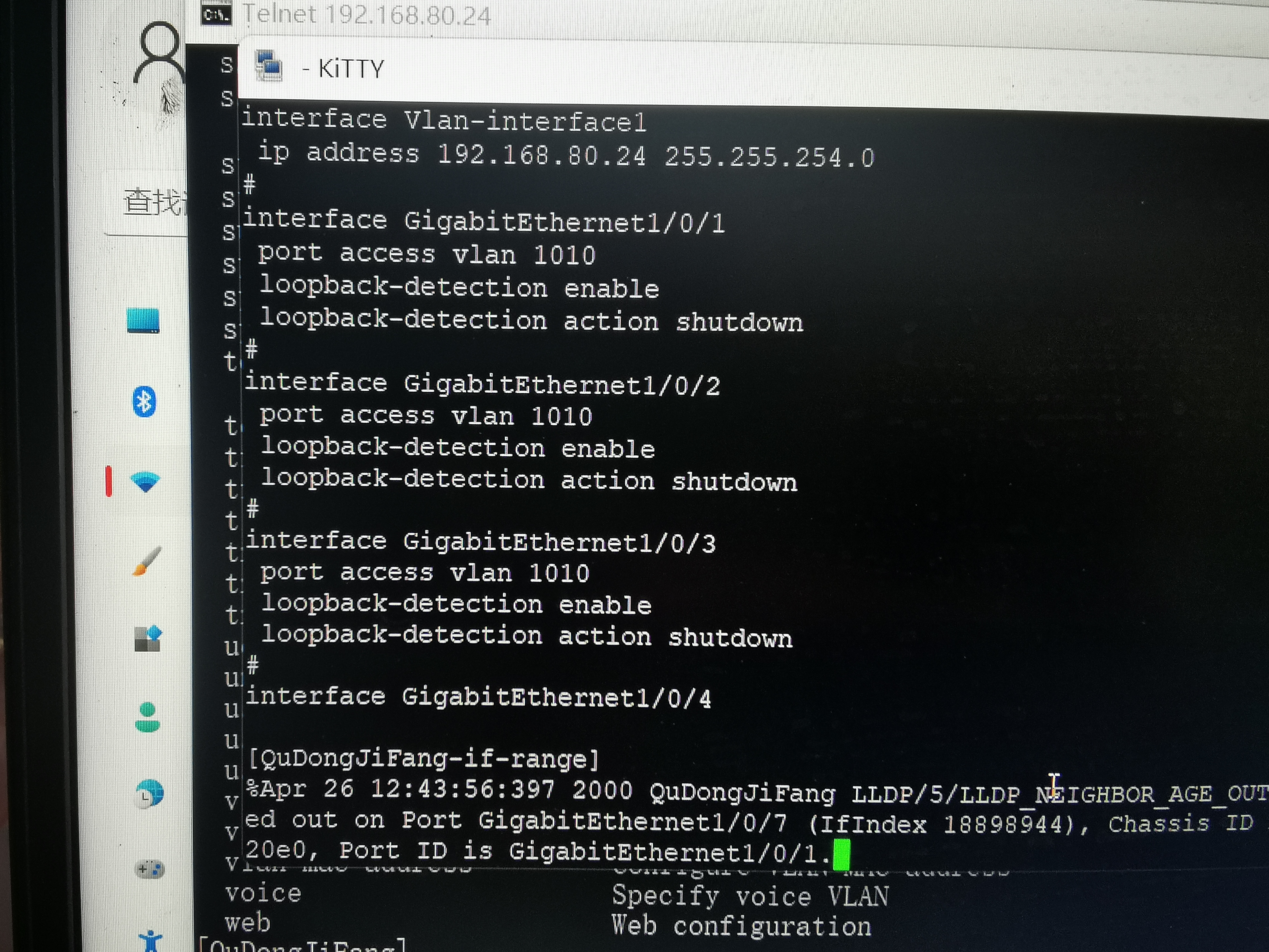

1、配置环路检测命令
全局模式下
 loopback-detection global enable vlan 1 to 4094
loopback-detection interval-time 250
接口模式下
 loopback-detection enable vlan 1 to 4094
loopback-detection action shutdown
2、环路检测和stp 不兼容,关闭stp
3、按照这样的配置你试试

loopback-detection 后边只有三个选项,enable,,,interval-time,,,,,multi-port-mode 我把VLAN删除以后,还是不能关闭端口

1、开启日志打印提示<>t d <>t m []in en 2、display loopback-detection看一下环路检测配置状态 3、display interface gigabitethernet 1/0/1 看一下接口状态,是否是Loopback detection down

#Apr 26 14:14:30:748 2000 QuDongJiFang LPDETECT/5/LOOPBACKED: Trap 1.3.6.1.4.1.25506.2.95.1.0.1<hh3cLpbkdtTrapLoopbacked>: Loopback exists on the interface 18874368 GigabitEthernet1/0/1. %Apr 26 14:14:30:975 2000 QuDongJiFang LPDETECT/5/LPDETECT_SHUTDOWN: Loopback exists on GigabitEthernet1/0/1 and this interface is shut down. %Apr 26 14:14:31:145 2000 QuDongJiFang IFNET/3/LINK_UPDOWN: GigabitEthernet1/0/1 link status is DOWN. %Apr 26 14:14:31:265 2000 QuDongJiFang IFNET/3/LINK_UPDOWN: GigabitEthernet1/0/2 link status is DOWN. %Apr 26 14:14:36:668 2000 QuDongJiFang IFNET/3/LINK_UPDOWN: GigabitEthernet1/0/1 link status is UP. %Apr 26 14:14:36:785 2000 QuDongJiFang IFNET/3/LINK_UPDOWN: GigabitEthernet1/0/2 link status is UP. %Apr 26 14:14:37:620 2000 QuDongJiFang LLDP/6/LLDP_CREATE_NEIGHBOR: New neighbor created on Port GigabitEthernet1/0/2 (IfIndex 18878464), Chassis ID is 48bd-3d7f-20e0, Port ID is GigabitEthernet1/0/1. %Apr 26 14:14:37:865 2000 QuDongJiFang LLDP/6/LLDP_CREATE_NEIGHBOR: New neighbor created on Port GigabitEthernet1/0/1 (IfIndex 18874368), Chassis ID is 48bd-3d7f-20e0, Port ID is GigabitEthernet1/0/2. #Apr 26 14:14:38:467 2000 QuDongJiFang LPDETECT/5/LOOPBACKED: Trap 1.3.6.1.4.1.25506.2.95.1.0.1<hh3cLpbkdtTrapLoopbacked>: Loopback exists on the interface 18874368 GigabitEthernet1/0/1. %Apr 26 14:14:38:695 2000 QuDongJiFang LPDETECT/5/LPDETECT_SHUTDOWN: Loopback exists on GigabitEthernet1/0/1 and this interface is shut down. %Apr 26 14:14:38:865 2000 QuDongJiFang IFNET/3/LINK_UPDOWN: GigabitEthernet1/0/1 link status is DOWN. %Apr 26 14:14:39:244 2000 QuDongJiFang IFNET/3/LINK_UPDOWN: GigabitEthernet1/0/2 link status is DOWN. %Apr 26 14:14:44:729 2000 QuDongJiFang IFNET/3/LINK_UPDOWN: GigabitEthernet1/0/1 link status is UP. %Apr 26 14:14:44:845 2000 QuDongJiFang IFNET/3/LINK_UPDOWN: GigabitEthernet1/0/2 link status is UP. %Apr 26 14:14:45:620 2000 QuDongJiFang LLDP/6/LLDP_CREATE_NEIGHBOR: New neighbor created on Port GigabitEthernet1/0/2 (IfIndex 18878464), Chassis ID is 48bd-3d7f-20e0, Port ID is GigabitEthernet1/0/1. %Apr 26 14:14:45:865 2000 QuDongJiFang LLDP/6/LLDP_CREATE_NEIGHBOR: New neighbor created on Port GigabitEthernet1/0/1 (IfIndex 18874368), Chassis ID is 48bd-3d7f-20e0, Port ID is GigabitEthernet1/0/2. #Apr 26 14:14:46:188 2000 QuDongJiFang LPDETECT/5/LOOPBACKED: Trap 1.3.6.1.4.1.25506.2.95.1.0.1<hh3cLpbkdtTrapLoopbacked>: Loopback exists on the interface 18874368 GigabitEthernet1/0/1. %Apr 26 14:14:46:415 2000 QuDongJiFang LPDETECT/5/LPDETECT_SHUTDOWN: Loopback exists on GigabitEthernet1/0/1 and this interface is shut down. %Apr 26 14:14:46:585 2000 QuDongJiFang IFNET/3/LINK_UPDOWN: GigabitEthernet1/0/1 link status is DOWN. %Apr 26 14:14:46:953 2000 QuDongJiFang IFNET/3/LINK_UPDOWN: GigabitEthernet1/0/2 link status is DOWN.

这提示已经发现环路,关闭了端口了,你把打印信息关闭一下,undo in en ,dis int g1/0/1 看一下接口状态

shutdown-interval 你是不是配置了这个,关闭一段时间后又打开,参看一下下面的连接 https://www.h3c.com/cn/d_201906/1208099_30005_0.htm
