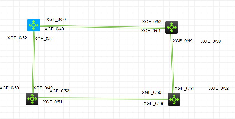

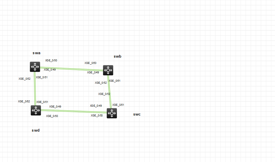

命令跟上边差不多下边的我就不写了,   我这样配置的顺序对吗,先让俩个堆叠完成,然后在与剩下的堆叠不可以吗?我在做的过程发现当你做完堆叠的配置后先进端口undo shutdown一下这样再重启时才能堆叠成功,附件里有图片,可以看下,有大佬可以帮忙配置一下吗,然后把每个设备上的配置发上来,再进行一下简单的说明,还有一个问题当堆叠失败了该怎么做呢?我发现堆叠失败后本来是  Ten-GigabitEthernet 1/0/49 的接口你进不去了他变成了Ten-GigabitEthernet 2/0/49  你打这个接口才能进去,  用命令恢复了出厂设置也不行,这种情况该怎么做呢?

首先这样连,然后所有的配置都是一样的
 [H3C]interface Ten-GigabitEthernet 1/0/49
[H3C-Ten-GigabitEthernet1/0/49]shu
interface Ten-GigabitEthernet 1/0/50
 [H3C-Ten-GigabitEthernet1/0/50]shu
 interface Ten-GigabitEthernet 1/0/51
[H3C-Ten-GigabitEthernet1/0/51]shu
 interface Ten-GigabitEthernet 1/0/52
[H3C-Ten-GigabitEthernet1/0/52]shu
[H3C-Ten-GigabitEthernet1/0/52]qu
[H3C]irf-port 1/1
 [ [H3C-irf-port1/1]port group in
[H3C-irf-port1/1]port group interface t
[H3C-irf-port1/1]port group interface Ten-GigabitEthernet 1/0/49
 [H3C-irf-port1/1]port group interface Ten-GigabitEthernet 1/0/50
 [H3C-irf-port1/1]qu
 [H3C]irf-port 1/2
 [H3C-irf-port1/2]port group interface Ten-GigabitEthernet 1/0/51
 [H3C-irf-port1/2]port group interface Ten-GigabitEthernet 1/0/52
[H3C-irf-port1/2]qu
  [H3C]irf member 1 r
 [H3C]irf member 1 renumber 1 Renumbering the member ID may result in configuration change or loss. C ontinue?[Y/N]:y
[ [H3C]irf-port [H3C]irf-port-configuration ac
[H3C]irf-port-configuration active
[H3C-Ten-GigabitEthernet1/0/49]un
 [H3C-Ten-GigabitEthernet1/0/49]undo shu
 [H3C-Ten-GigabitEthernet1/0/49]interface Ten-GigabitEthernet 1/0/50
 [H3C-Ten-GigabitEthernet1/0/50]undo shu
 [H3C-Ten-GigabitEthernet1/0/50]interface Ten-GigabitEthernet 1/0/51
 [H3C-Ten-GigabitEthernet1/0/51]undo shu
 [H3C-Ten-GigabitEthernet1/0/51]interface Ten-GigabitEthernet 1/0/52
[H3C-Ten-GigabitEthernet1/0/52]undo shu
