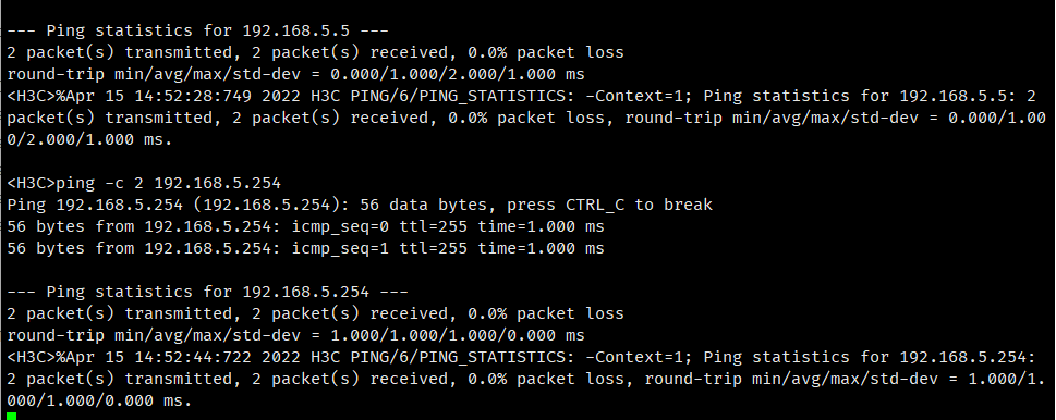

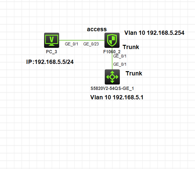

0x0. 需求防火墙二层通信,设备处于同一VLAN
0x1.简单处理方法记录一下
1)PC_3 配置IP地址 192.168.5.5 /24
2)S5820v2 接口配置
[sw-GigabitEthernet1/0/1]dis this
 port link-mode bridge
 port link-type trunk
 undo port trunk permit vlan 1
 port trunk permit vlan 10
 combo enable fiber
return
   S5820v2 vlan 配置
[sw-Vlan-interface10]dis this
 interface Vlan-interface10
 ip address 192.168.5.254 255.255.255.0
return
3)防火墙配置
(a) 接口配置 gig1/0/23  gig1/0/1
 interface GigabitEthernet1/0/23
 port access vlan 10
 combo enable copper
return
 port trunk permit vlan 1 10
 combo enable copper
return
(b) vlan 配置IP地址
[H3C-Vlan-interface10]dis this
 ip address 192.168.5.1 255.255.255.0
 return
(c)创建安全域 AP
[H3C]security-zone name ap
[H3C-security-zone-ap]dis this
 import interface Vlan-interface10
 import interface GigabitEthernet1/0/1 vlan 10
return
(d)创建安全策略
参考 https://zhiliao.h3c.com/Theme/details/136909
[H3C]security-policy ip
[H3C-security-policy-ip]dis this
security-policy ip
 rule 0 name ap-local
 action pass
 source-zone ap
 destination-zone local
 rule 5 name local-ap
 action pass
 source-zone local
 destination-zone ap
return
