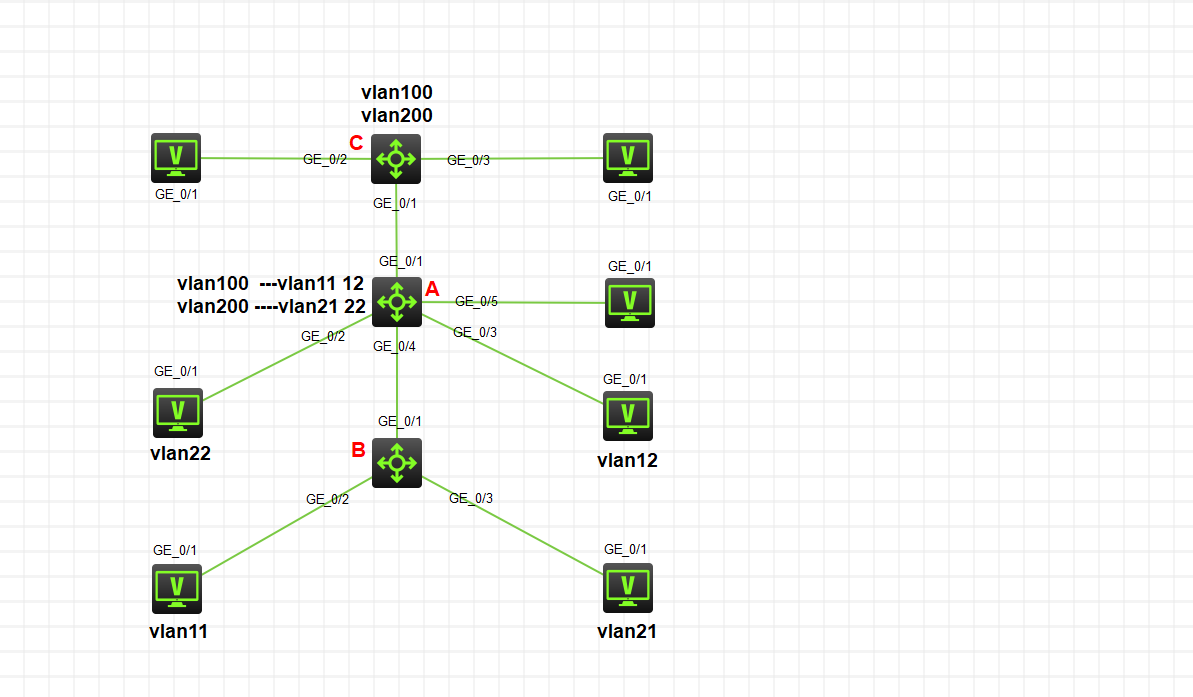

private vlan 100 200开启DHCP   Secondary VLAN   11 12 21 22获取不到IP地址

配置呢,可以粘出来一起看下,vlan11 12没有配置dhcp吗?
zhiliao_DfBLR 知了小白
#sysname A
vlan 1
vlan 11 to 12
vlan 21 to 22
vlan 100
 private-vlan primary
 private-vlan secondary 11 to 12
vlan 200
 private-vlan secondary 21 to 22
 stp global enable
interface NULL0
 port link-mode bridge
 port link-type hybrid
 port hybrid vlan 11 to 12 21 to 22 100 200 tagged
 port hybrid vlan 1 untagged
 port private-vlan 100 200 trunk promiscuous
 combo enable fiber
 undo port hybrid vlan 1
 port hybrid vlan 22 200 untagged
 port hybrid pvid vlan 22
 port private-vlan host
 combo enable fiber
 port hybrid vlan 12 100 untagged
 port hybrid pvid vlan 12
 combo enable fiber
interface GigabitEthernet1/0/4
 port hybrid vlan 11 21 100 200 tagged
 port private-vlan 11 21 trunk secondary
 combo enable fiber
sysname C
 irf mac-address persistent timer
 irf auto-update enable
 undo irf link-delay
 irf member 1 priority 1
 dhcp enable
 lldp global enable
 system-working-mode standard
 xbar load-single
 password-recovery enable
 lpu-type f-series
vlan 1
vlan 100
vlan 200
 stp global enable
dhcp server ip-pool 100
 gateway-list 192.168.100.1
 network 192.168.100.0 mask 255.255.255.0
dhcp server ip-pool 200
 gateway-list 192.168.200.1
 network 192.168.200.0 mask 255.255.255.0
interface NULL0
interface Vlan-interface100
 ip address 192.168.100.1 255.255.255.0
 dhcp server apply ip-pool 100
interface Vlan-interface200
 ip address 192.168.200.1 255.255.255.0
 dhcp server apply ip-pool 200
interface FortyGigE1/0/53
interface FortyGigE1/0/54
 port hybrid vlan 100 200 tagged
 combo enable fiber
sysname B
<B>system-view
System View: return to User View with Ctrl+Z.
[B]DIS CU
 version 7.1.075, Alpha 7571
 sysname B
 undo irf link-delay
 lldp global enable
 xbar load-single
 lpu-type f-series
vlan 1
vlan 11
vlan 21
 stp global enable
interface NULL0
 port hybrid vlan 11 21 tagged
 combo enable fiber
 port access vlan 11
 combo enable fiber
 port access vlan 21
 combo enable fiber
