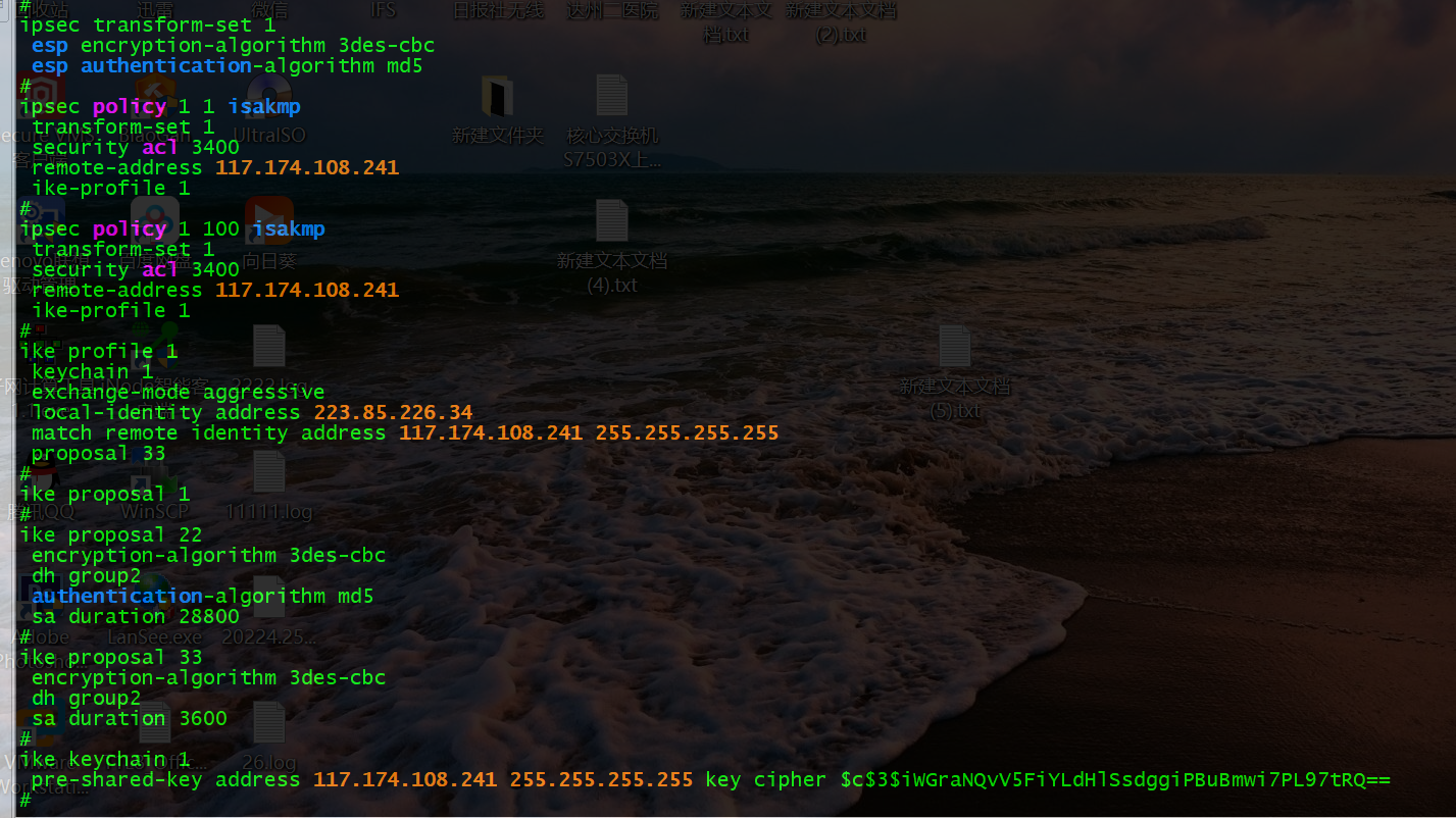

  在防火墙上看到有连接失败的日志
 <JTsanyiyuanCORE_1>ping -a 172.75.76.252 10.20.192.11 PING 10.20.192.11: 56 data bytes, press CTRL_C to break*Apr 26 10:01:54:123 2022 JTSYY IPSEC/7/EVENT: -COntext=1; Can't find block-flow node. *Apr 26 10:01:54:123 2022 JTSYY IPSEC/7/PACKET: -COntext=1; Failed to find SA by SP, SP Index = 1, SP Convert-Seq = 65536. *Apr 26 10:01:54:123 2022 JTSYY IPSEC/7/ERROR: -COntext=1; The reason of dropping packet is no available IPsec tunnel. *Apr 26 10:01:54:123 2022 JTSYY IPSEC/7/EVENT: -COntext=1; Sent SA-Acquire message : SP ID = 1 *Apr 26 10:01:54:124 2022 JTSYY IPSEC/7/EVENT: -COntext=1; Received negotiatiate SA message from IPsec kernel. *Apr 26 10:01:54:124 2022 JTSYY IPSEC/7/EVENT: -COntext=1; Got SA time-based soft lifetime settings when filling Sp data. Configured soft lifetime buffer : 0 seconds. Configured global soft lifetime buffer : 0 seconds. %Apr 26 10:01:54:227 2022 JTSYY SYSLOG/5/LOGFILE_USAGEHIGH: -COntext=1; The usage of log-file flash:/logfile/atk_single.log reaches 80%. Request time out*Apr 26 10:01:56:349 2022 JTSYY IPSEC/7/EVENT: -COntext=1; Found block-flow node. *Apr 26 10:01:56:349 2022 JTSYY IPSEC/7/PACKET: -COntext=1; Failed to find SA by SP, SP Index = 1, SP Convert-Seq = 65536. *Apr 26 10:01:56:349 2022 JTSYY IPSEC/7/ERROR: -COntext=1; The reason of dropping packet is no available IPsec tunnel. Request time out*Apr 26 10:01:58:574 2022 JTSYY IPSEC/7/EVENT: -COntext=1; Found block-flow node. *Apr 26 10:01:58:574 2022 JTSYY IPSEC/7/PACKET: -COntext=1; Failed to find SA by SP, SP Index = 1, SP Convert-Seq = 65536. *Apr 26 10:01:58:574 2022 JTSYY IPSEC/7/ERROR: -COntext=1; The reason of dropping packet is no available IPsec tunnel. Request time out*Apr 26 10:02:00:799 2022 JTSYY IPSEC/7/EVENT: -COntext=1; Found block-flow node. *Apr 26 10:02:00:799 2022 JTSYY IPSEC/7/PACKET: -COntext=1; Failed to find SA by SP, SP Index = 1, SP Convert-Seq = 65536. *Apr 26 10:02:00:799 2022 JTSYY IPSEC/7/ERROR: -COntext=1; The reason of dropping packet is no available IPsec tunnel. Request time out*Apr 26 10:02:03:023 2022 JTSYY IPSEC/7/EVENT: -COntext=1; Found block-flow node. *Apr 26 10:02:03:023 2022 JTSYY IPSEC/7/PACKET: -COntext=1; Failed to find SA by SP, SP Index = 1, SP Convert-Seq = 65536. *Apr 26 10:02:03:023 2022 JTSYY IPSEC/7/ERROR: -COntext=1; The reason of dropping packet is no available IPsec tunnel. Request time out --- 10.20.192.11 ping statistics --- 5 packet(s) transmitted 0 packet(s) received 100.00% packet loss
深信服设备配置如下

认证算法不对,H3C是md5,深信服是sha-1,改一下再试试
回复zhiliao_irtKC:
还真是,看成22了,那光看配置,好像也没啥问题,你把两边的ike sa和ipsec sa都清空下,然后deb ike,你上边上去像是deb了ipsec,其实不用deb ipsec,deb ike,看下ike协商过程,看看是卡在那个阶段,如果ike有拆线消息,看下是那边发起的拆线

是对的啊,like proposal 33是sha1
