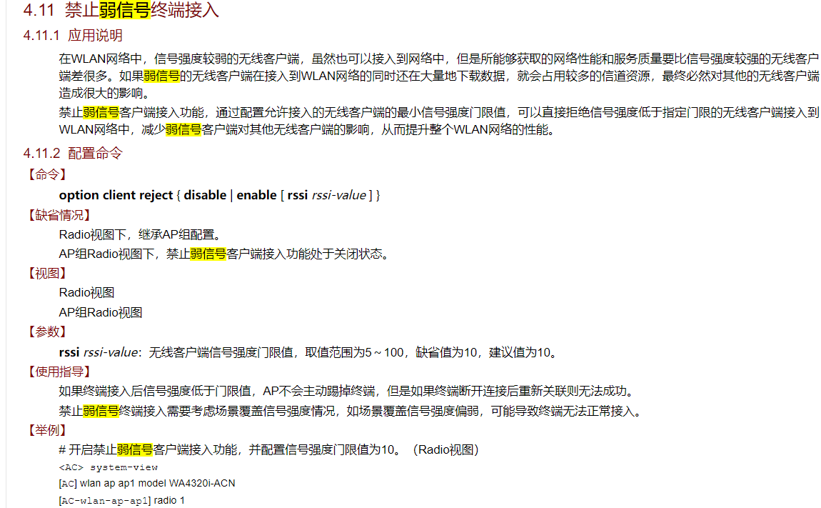

fat版本手册里没这些功能啊,不一定支持。可能要fit版本结合AC才行。
手册:
https://www.h3c.com/cn/d_201707/1017279_30005_0.htm

这个页面的命令我执行不了 比如配置禁止弱信号客户端接入功能 (1) 进入系统视图。 system-view (2) 进入AP视图或AP组视图的AP型号视图。 ¡ 进入AP视图。 wlan ap ap-name 我的AP没有这条命令 [ap_1]wlan ? broadcast-probe Broadcast probe response configuration client Wireless client country-code ISO country code device-detection Device detection error-frame Specify the errored frame event ids Intrusion detection system mesh Mesh network mesh-profile Profile for mesh network mesh-snmp Configure SNMP for mesh networks mp-policy MP policy for a radio multicast Specify multicast configuration option Wlan optimization options retry-frame Specify the retry frame event rrm Radio resource management service-template Service template for ESS statistics Statistics information uplink-interface Specify uplink interface work-mode AP work mode 我的系统版本是 [ap_1]dis version H3C Comware Platform Software Comware Software, Version 5.20, Release 1509P01 Copyright (c) 2004-2018 New H3C Technologies Co., Ltd. All rights reserved. H3C WA4320-ACN-C uptime is 9 weeks, 4 days, 17 hours, 41 minutes CPU type: ATHEROS AR9563 128M bytes DDR2 SDRAM Memory 16M bytes Flash Memory Pcb Version: Ver.B Basic BootROM Version: 1.04 Extend BootROM Version: 1.06

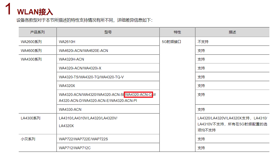

您好,可以参考下这个里面:
https://www.h3c.com/cn/d_201812/1140846_30005_0.htm#_Toc532998251
这个文档实在很对4320-ACN系列的,你可以试一下,看有没有用哈
我刚试了下。我只能通过 [ap_1]int WLAN-Radio 1/0/1 进入接口,但是无法执行后面的命令 您看还有别的办法吗
