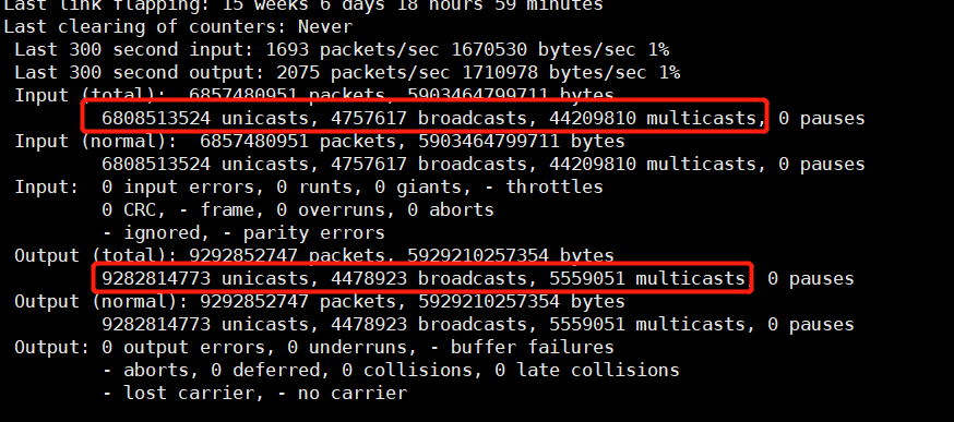

交换机查看某个接口的单播,广播流量命令是什么

dis int g1/0/1  看红框内的   一次是单播、广播、组播
粉丝:4人 关注:0人
[HZB7-R2-S5560-EI]display interface g 2/0/10
GigabitEthernet2/0/10
Current state: DOWN
Line protocol state: DOWN
IP packet frame type: Ethernet II, hardware address: 3c8c-406b-dae4
Description: GigabitEthernet2/0/10 Interface
Bandwidth: 1000000 kbps
Loopback is not set
Media type is twisted pair
Port hardware type is 1000_BASE_T
Unknown-speed mode, unknown-duplex mode
Link speed type is autonegotiation, link duplex type is autonegotiation
Flow-control is not enabled
Maximum frame length: 12288
Allow jumbo frames to pass
Broadcast max-ratio: 100%
Multicast max-ratio: 100%
Unicast max-ratio: 100%
PVID: 1
MDI type: Automdix
Port link-type: Access
Tagged VLANs: None
Untagged VLANs: 1
Port priority: 0
Last link flapping: Never
Last clearing of counters: Never
Current system time:2022-05-14 13:44:35 beijing+08:00:00
Last time when physical state changed to up:-
Last time when physical state changed to down:2022-05-13 19:02:06 beijing+08:00:00
Peak input rate: 0 bytes/sec, at 2022-05-14 03:02:38
Peak output rate: 0 bytes/sec, at 2022-05-14 03:02:38
Last 300 seconds input: 0 packets/sec 0 bytes/sec -%
Last 300 seconds output: 0 packets/sec 0 bytes/sec -%
Input (total): 0 packets, 0 bytes
0 unicasts, 0 broadcasts, 0 multicasts, 0 pauses
Input (normal): 0 packets, - bytes
Input: 0 input errors, 0 runts, 0 giants, 0 throttles
0 CRC, 0 frame, - overruns, 0 aborts
- ignored, - parity errors
Output (total): 0 packets, 0 bytes
Output (normal): 0 packets, - bytes
Output: 0 output errors, - underruns, - buffer failures
0 aborts, 0 deferred, 0 collisions, 0 late collisions
0 lost carrier, - no carrier

display cou interface
