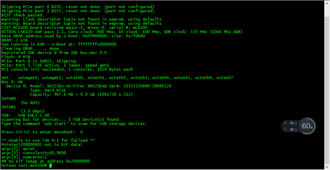

ACG1000-T意外断电后,系统损坏了,只能进入下界面,按Ctrl+C也没有反应。根据https://zhiliao.h3c.com/Theme/details/7626,需要升级menuboot,再升级image就可以修复,请问menuboot谁有啊,麻烦提供一下,多谢。

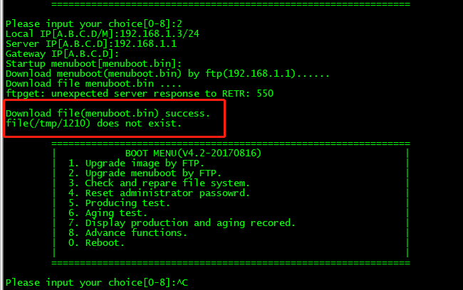

貌似在进行升级menuboot的时候出现了问题   不知道是什么原因,麻烦帮忙看看,如下图,谢谢:

Octeon cust_mc6100#
Octeon cust_mc6100# setenv serverip 192.168.1.1
Octeon cust_mc6100# setenv ipaddr 192.168.1.2
Octeon cust_mc6100# ping 192.168.1.1
Using octmgmt0 device
host 192.168.1.1 is alive
Octeon cust_mc6100# run menuboot

Please input your choice[0-8]:2
Local IP[A.B.C.D/M]:192.168.1.3/24
Server IP[A.B.C.D]:192.168.1.1
Gateway IP[A.B.C.D]:
Startup menuboot[menuboot.bin]:
Download menuboot(menuboot.bin) by ftp(192.168.1.1)......
Download file menuboot.bin ....
ftpget: unexpected server response to RETR: 550
Download file(menuboot.bin) success.
file(/tmp/1210) does not exist.
| BOOT MENU(V4.2-20170816) |
| 1. Upgrade image by FTP. |
| 2. Upgrade menuboot by FTP. |
| 3. Check and repare file system. |
| 4. Reset administrator passowrd. |
| 5. Producing test. |
| 6. Aging test. |
| 7. Display production and aging recored. |
| 8. Advance functions. |
| 0. Reboot. |
