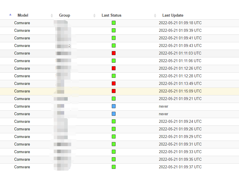

    to detect prompt: (?-mix:^.*(<[\w#.-]+>)$)" W, [2022-05-21T01:10:03.817646 #28] WARN -- : 南区办公/13) C栋1楼办公 status no_connection, retry attempt 1 W, [2022-05-21T01:10:23.822267 #28] WARN -- : 66.66.66.30 raised Oxidized::PromptUndetect with msg "unable to detect prompt: (?-mix:^.*(<[\w#.-]+>)$)" W, [2022-05-21T01:10:23.838336 #28] WARN -- : 南区办公/13) C栋1楼办公 status no_connection, retry attempt 2 W, [2022-05-21T01:10:43.842886 #28] WARN -- : 66.66.66.30 raised Oxidized::PromptUndetect with msg "unable to detect prompt: (?-mix:^.*(<[\w#.-]+>)$)" W, [2022-05-21T01:10:43.858257 #28] WARN -- : 南区办公/13) C栋1楼办公 status no_connection, retry attempt 3 W, [2022-05-21T01:11:03.862957 #28] WARN -- : 66.66.66.30 raised Oxidized::PromptUndetect with msg "unable to detect prompt: (?-mix:^.*(<[\w#.-]+>)$)" W, [2022-05-21T01:11:03.879417 #28] WARN -- : 南区办公/13) C栋1楼办公 status no_connection, retries exhausted, giving up I, [2022-05-21T01:11:06.882593 #28] INFO -- : Configuration updated for 南区办公/14) C栋2楼SD办公

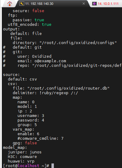

额,这个就不关交换机啥事了吧,可以看看这个oxidized 设置方法

oxidized 连接不上交换机
zhiliao_NEs3JY 发表时间:2022-05-21
在linux底下是可以正常连接的 这个鬼软件就是连接不上 导致备份失败

查看交换机命名,应该是有中文字符吧
