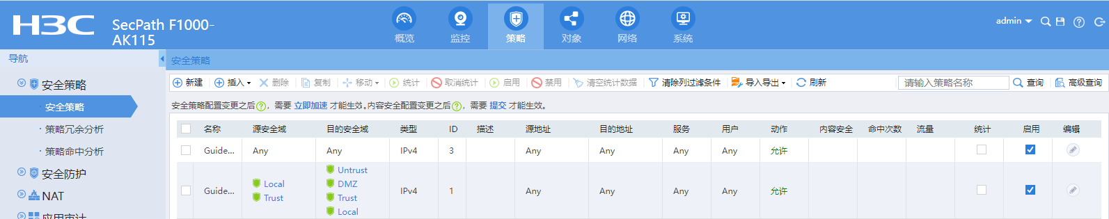

3、ak115的安全策略中有源安全域、目标安全域都是any的策略。
4、PC机的网关为ak115时,外网电脑上的softether客户端无法连接内网电脑上的softether服务端;

3、策略没问题

security-policy ip
rule 3 name GuideSecPolicy3
action pass
rule 1 name GuideSecPolicy
action pass
source-zone Local
source-zone Trust
destination-zone Untrust
destination-zone DMZ
destination-zone Trust
destination-zone Local
rule 2 name GuideSecPolicy-1
action pass
