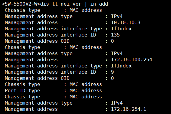

dis ll nei ver | in add 查看所有邻居的IP

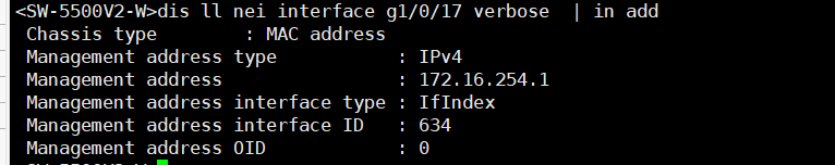

dis ll nei interface g1/0/17 verbose | in add   查看17口邻居的IP
