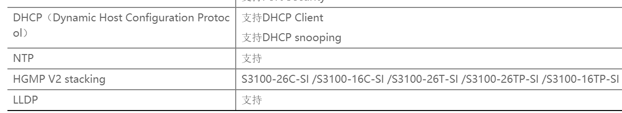

zhiliao_XcWTCa 知了小白
华三s3100-52tp-si v3.10 r2211p06 没有dhcp select relay dhcp relay server-address
S3100SI不支持DHCP Server
