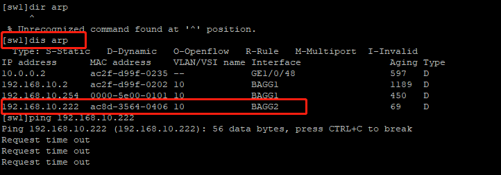

红色链路断开之后,由于vrrp做了track的,192.168.10.254地址成功飘移到了sw2 ,但是sw1上的int vlan10接口(192.168.10.1)再也ping 不通pc4了(192.168.10.222),这样就失去DRNI跨设备链路聚合的冗余意义了吧,故障所图:
有以下问题:
对于交换机SW1而言xge_0/51掉线后,BGAA2接口是不是应该失效并消失?
如果说是因为DRNI系统内的SW2还有BGAA2链路,故SW1上BGAA2才继续存在的,那为何流量不切换到BAGG1的IPL链路到达SW2 呢?
SW1主要配置(SW2也类似)
track 1 interface Ten-GigabitEthernet1/0/51
 interface Bridge-Aggregation1
port link-type trunk
port trunk permit vlan all
 link-aggregation mode dynamic
 port drni intra-portal-port 1
interface Bridge-Aggregation2
 port link-type trunk port trunk permit vlan all
 port drni group 1
interface Vlan-interface10
 ip address 192.168.10.1 255.255.255.0
 vrrp vrid 1 virtual-ip 192.168.10.254
 vrrp vrid 1 priority 110 vrrp vrid 1 track 1 priority reduced 20
 drni system-mac ac2f-d99f-0204
 drni system-number 1 drni system-priority 100
 drni keepalive ip destination 10.0.0.2 source 10.0.0.1

补充的配置 interface GigabitEthernet1/0/48 port link-mode route combo enable fiber ip address 10.0.0.1 255.255.255.0 interface Ten-GigabitEthernet1/0/49 port link-mode bridge port link-type trunk port trunk permit vlan all combo enable fiber port link-aggregation group 1 # interface Ten-GigabitEthernet1/0/50 port link-mode bridge port link-type trunk port trunk permit vlan all combo enable fiber port link-aggregation group 1 drni system-mac ac2f-d99f-0204 drni system-number 1 drni system-priority 100 drni keepalive ip destination 10.0.0.2 source 10.0.0.1 drni mad exclude interface GigabitEthernet1/0/48
