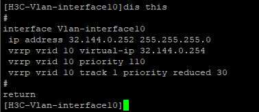

hcl中配置vrrp,关闭电信,或移动交换机能正常切换
master设备关机后 Backup设备 的状态变成了State : Initialize
master配置如下
backup配置如下
屏幕上面会提示这个:
[H3C]dis cu%Jun 12 08:02:41:449 2022 H3C VRRP4/6/VRRP_STATUS_CHANGE: The status of IPv4 virtual router 10 (configured on Vlan-interface10) changed from Backup to Master: Master-down-timer expired. %Jun 12 08:02:42:666 2022
H3C VRRP4/6/VRRP_STATUS_CHANGE: The status of IPv4 virtual router 10 (configured on Vlan-interface10) changed from Master to Initialize: Interface event received. %Jun 12 08:02:42:666 2022 H3C IFNET/3/PHY_UPDOWN: Physical state on the interface GigabitEthernet1/0/24 changed to down. %Jun 12 08:02:42:666 2022 H3C IFNET/5/LINK_UPDOWN: Line protocol state on the interface GigabitEthernet1/0/24 changed to down. %Jun 12 08:02:42:666 2022 H3C IFNET/3/PHY_UPDOWN: Physical state on the interface Vlan-interface10 changed to down. %Jun 12 08:02:42:666 2022 H3C IFNET/5/LINK_UPDOWN: Line protocol state on the interface Vlan-interface10 changed to down.

提示的很明显了呀,由于master关机导致backup的24口down从而导致vlan-if 10接口down。
接口都down还怎么成为vrrp master。。。
这个问题是配置或组网导致,根据反馈拓扑。正常情况下即使master故障离线backup也会因G0/2接口up接管vrrp master角色。除非vrrp仅在master和backup的G0/24之间保持或master和接入交换机同时故障则无解。
仔细检查下配置和组网细节吧
都说了,要看组网需求和细节。如果只考虑vrrp的话。可以解决backup无法接管master问题。

谢谢大神,我backup的G0/24和g0/2都只加了port access vlan 10,能行吗还需要配置别的吗?
zhiliao_iwqhzs 发表时间:2022-06-12
