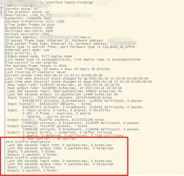

交换机display interface回显中的IPv4 traffic statistics统计
  • 1收藏,4547浏览
场景:AD-DC6.0
设备:S6850-56HF
版本:R6635
执行display interface TWX/X/X查看接口下流量统计情况时,回显中IPv4 traffic statistics字段是用来统计什么信息的呢?
已经在设备上ping大包测试,该字段不会有任何计数变化,求大神帮忙看看这个字段是统计什么信息,是否需要提前在设备上开启什么类型的统计功能,谢谢。

# 查看二层以太网接口Ten-GigabitEthernet1/0/1的运行状态和相关信息。
<Sysname> display interface ten-gigabitethernet 1/0/1
Current state: DOWN
Line protocol state: DOWN
IP packet frame type: Ethernet II, hardware address: 000c-2963-b767
Description: Ten-GigabitEthernet1/0/1 Interface
Bandwidth: 100000 kbps
Loopback is not set
Media type is twisted pair, port hardware type is 1000_BASE_T_AN_SFP
Unknown-speed mode, unknown-duplex mode
Link speed type is autonegotiation, link duplex type is autonegotiation
Flow-control is not enabled
Maximum frame length: 9216
Allow jumbo frame to pass
Broadcast max-ratio: 100%
Multicast max-ratio: 100%
Unicast max-ratio: 100%
PVID: 1
MDI type: Automdix
Port link-type: Access
 Tagged VLANs:   None
 UnTagged VLANs: 1
Port priority: 2
Last link flapping: 6 hours 39 minutes 25 seconds
Last clearing of counters:  14:34:09 Tue 11/01/2011
Current system time:2018-08-10 14:58:27
Last time when physical state changed to up:-
Last time when physical state changed to down:2018-08-10 14:57:58
 Peak input rate: 0 bytes/sec, at 2013-07-17 22:06:19
 Peak output rate: 0 bytes/sec, at 2013-07-17 22:06:19
 Last 300 seconds input:  0 packets/sec 0 bytes/sec -%
 Last 300 seconds output:  0 packets/sec 0 bytes/sec -%
 Input (total):  0 packets, 0 bytes
          0 unicasts, 0 broadcasts, 0 multicasts, 0 pauses
 Input (normal):  0 packets, 0 bytes
 Input:  0 input errors, 0 runts, 0 giants, 0 throttles
          0 CRC, 0 frame, 0 overruns, 0 aborts
          0 ignored, 0 parity errors
 Output (total): 0 packets, 0 bytes
 Output (normal): 0 packets, 0 bytes
 Output: 0 output errors, 0 underruns, 0 buffer failures
          0 aborts, 0 deferred, 0 collisions, 0 late collisions
          0 lost carrier, 0 no carrier
