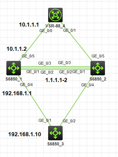

SW1:
 drni system-mac 0000-0000-0001
 drni system-number 1
 drni system-priority 100
 drni keepalive ip destination 1.1.1.2 source 1.1.1.1
 drni mad exclude interface GigabitEthernet1/0/3
 drni mad exclude interface Vlan-interface10
 drni mad exclude interface Vlan-interface20
 ip address 10.1.1.2 255.255.255.252
 mac-address 0000-1111-1111
interface GigabitEthernet1/0/5
 port link-mode bridge
 port access vlan 10
 combo enable fiber
 port link-aggregation group 10
interface Bridge-Aggregation10
 port access vlan 10
 link-aggregation mode dynamic
 port drni group 10
SW2:
 drni system-number 2
 drni keepalive ip destination 1.1.1.1 source 1.1.1.2
 port access vlan 10
 combo enable fiber
 port access vlan 10
 port drni group 10
SW1和SW2 的配置如上: vlan10做为上联,drni接口显示down
[SW2]display drni summary
IPP: BAGG1
 IPP state (cause): UP
 Keepalive link state (cause): UP
DR interface DR group Local state (cause) Peer state Remaining down time(s)
BAGG10          10      DOWN (A)      DOWN -
BAGG20          20         UP                 UP -
  【【【请教故障原因!!!】】】

请提供完整的配置
这个配置不完整,可以参考一下完成的drni配置
其他配置相关的现象都正常,只有上联口的现场不对,接口DOWN,
