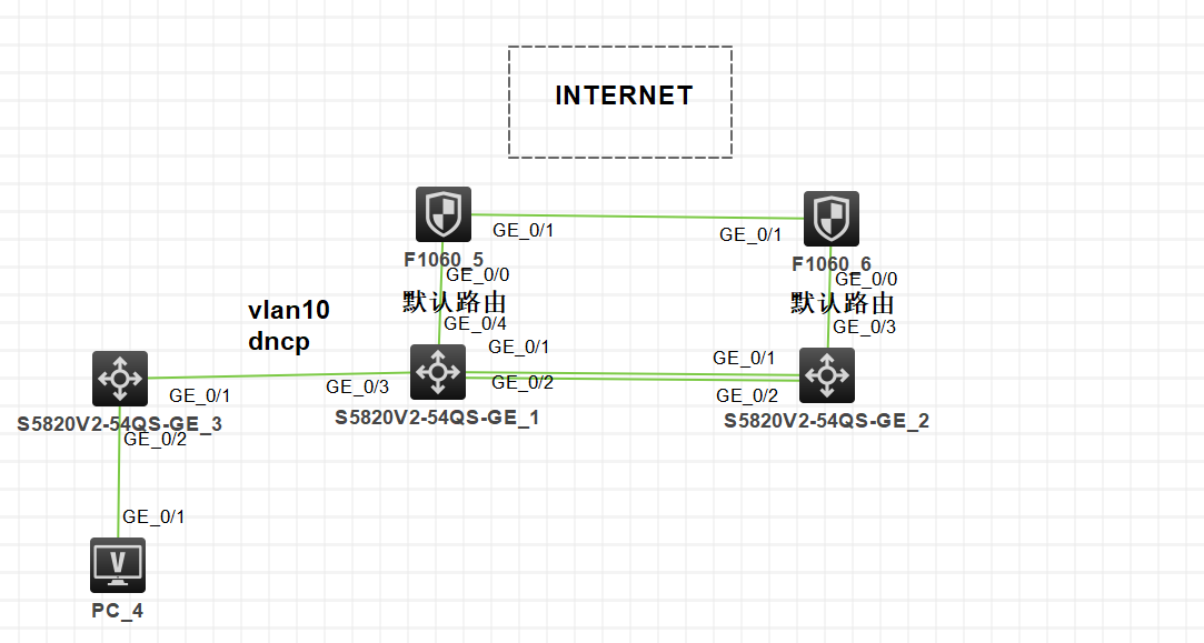

不做VRRP,单DCHP下的业务能走主备吗
2022-07-01提问
  • 1收藏,2144浏览
1给3分配地址,3设备只跟1设备连接的话,1跟5线路断的话会走2设备吗,或者怎么实现?(不做vrrp)
通过track去控制

56 bytes from 3.3.3.3: icmp_seq=4 ttl=254 time=1.000 ms
--- Ping statistics for 3.3.3.3 ---
round-trip min/avg/max/std-dev = 1.000/2.000/4.000/1.265 ms
[H3C]%May 29 10:21:41:325 2019 H3C PING/6/PING_STATISTICS: Ping statistics for 3.3.3.3: 5 packet(s) transmitted, 5 packet(s) received, 0.0% packet loss, round-trip min/avg/max/std-dev = 1.000/2.000/4.000/1.265 ms.
您好,根据最短路径选择
