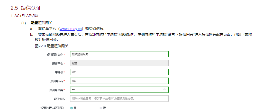

https://www.h3c.com/cn/d_202112/1519704_30005_0.htm#_Toc91236572
