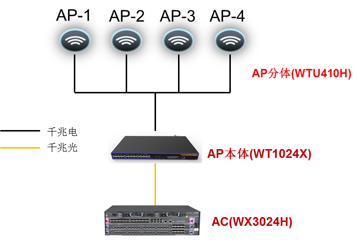

组网结构:
AP在网络中使用二层注册方式,经过查阅相关资料WTU410H只支持version1也就是直通模式,当前在AC上将本体AP切换到version1模式并进行重启,AC上通过display wlan ap all命令查看发现本体AP已经自动注册,但没有看到AP分体;查看分体的供电情况指示灯也是亮绿色,进一步在AC上通过display arp interface ten-g1/0/1 命令查看AC下连口的ARP信息,发现存在5条ARP信息证明分体式可以获取到AC上地址的,通过在AC上也能ping通5个ARP信息当中的地址。
在AC上telnet AP本体,通过display interface brief 命令查看接口状态均UP,进入到probe视图下通过display mac-address只能看到上联口MAC地址,并没有看到分体的MAC地址。
AC上的debug信息:

从debug看,AC回复了 discovery response  之后,分体并未发起join,AC计时器超时。
这种现象,大概率是二层网络中存在其他capwap设备,也回复了discovery response 。
可以telnet到分体AP上,配置wlan ac ip证实这一点。或者找AP上debug capwap,就能看到哪个ip也在充当AC的角色。

*Sep 3 14:17:51:618 2018 WX3024H CWS/7/EVENT: usApcbConnectingCnt is 0.
*Sep 3 14:17:51:618 2018 WX3024H CWS/7/RCV_PKT: Received discovery request from AP: IP address=192.168.1.4, MAC address=74ea-cbe9-b6f0, serial ID=219801A11T9177Q00754.
*Sep 3 14:17:51:619 2018 WX3024H CWS/7/EVENT: Filling AC Descriptor TLV. LicenseType[2] MaxSupportNum[128] JoinCount[0].
*Sep 3 14:17:51:620 2018 WX3024H CWS/7/SND_PKT: Sent discovery response with SeqNum 0 to AP at 192.168.1.4:27305.
*Sep 3 14:17:51:620 2018 WX3024H CWS/7/SND_PKT: Sent discovery response to AP at 192.168.1.4:27305, Length=119.
 00 10 02 00 00 00 00 00 00 00 00 02 00 00 6A 00
00 01 00 31 00 00 FF FF 00 00 00 80 00 02 00 02
00 00 00 00 00 04 00 04 00 00 00 41 00 00 00 00
00 05 00 03 39 39 00 00 00 00 00 01 00 00 06 80
F6 2E 58 CD 78 00 04 00 12 57 69 72 65 6C 65 73
73 43 6F 6E 74 72 6F 6C 6C 65 72 04 18 00 05 01
00 00 00 0D 00 25 00 0F 00 00 63 A2 00 80 00 01
 04 00 00 00 02 00 01 .
*Sep 3 14:17:51:621 2018 WX3024H CWS/7/RCV_PKT: Received discovery request with SeqNum 0 from AP at 192.168.1.4:27305.
*Sep 3 14:17:51:621 2018 WX3024H CWS/7/RCV_PKT: Received discovery request from AP at 192.168.1.4:27305, Length=146.
 00 10 02 00 00 00 00 00 00 00 00 01 00 00 85 00
00 14 00 01 00 00 26 00 3A 00 00 63 A2 00 00 00
07 57 54 55 34 31 30 48 00 01 00 14 32 31 39 38
30 31 41 31 31 54 39 31 37 37 51 30 30 37 35 34
00 03 00 05 56 65 72 2E 41 00 04 00 06 74 EA CB
E9 B6 F0 00 27 00 28 04 04 01 01 00 00 00 00 63
A2 00 00 00 01 41 00 00 63 A2 00 01 00 05 52 32
31 32 30 00 00 63 A2 00 02 00 04 37 2E 30 32 00
29 00 01 0E 00 2C 00 01 02 04 18 00 05 01 00 00
 00 0D .
*Sep 3 14:17:51:621 2018 WX3024H CWS/7/EVENT: usApcbConnectingCnt is 0.
*Sep 3 14:17:51:621 2018 WX3024H CWS/7/RCV_PKT: Received discovery request from AP: IP address=192.168.1.4, MAC address=74ea-cbe9-b6f0, serial ID=219801A11T9177Q00754.
*Sep 3 14:17:51:622 2018 WX3024H CWS/7/EVENT: Filling AC Descriptor TLV. LicenseType[2] MaxSupportNum[128] JoinCount[0].
*Sep 3 14:17:51:623 2018 WX3024H CWS/7/SND_PKT: Sent discovery response with SeqNum 0 to AP at 192.168.1.4:27305.
*Sep 3 14:17:51:623 2018 WX3024H CWS/7/SND_PKT: Sent discovery response to AP at 192.168.1.4:27305, Length=119.
