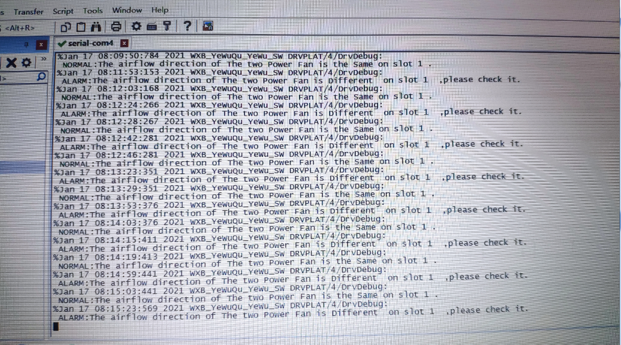

 %Jan 17 08:15:03:441 2021 WXB_yewuou_Yewu_SWDRVPLAT/4/DrVDebug: NORMAL: The airflow direction of The two Power Fan is the Same on slot 1.
%Jan 17 08:15:23:569 2021 wxB Yewuou Yewu_SW DRVPLAT/4/DrVDebug: ALARM: The airflow direction of The two Power Fan is Different on slot 1 ,please check it.

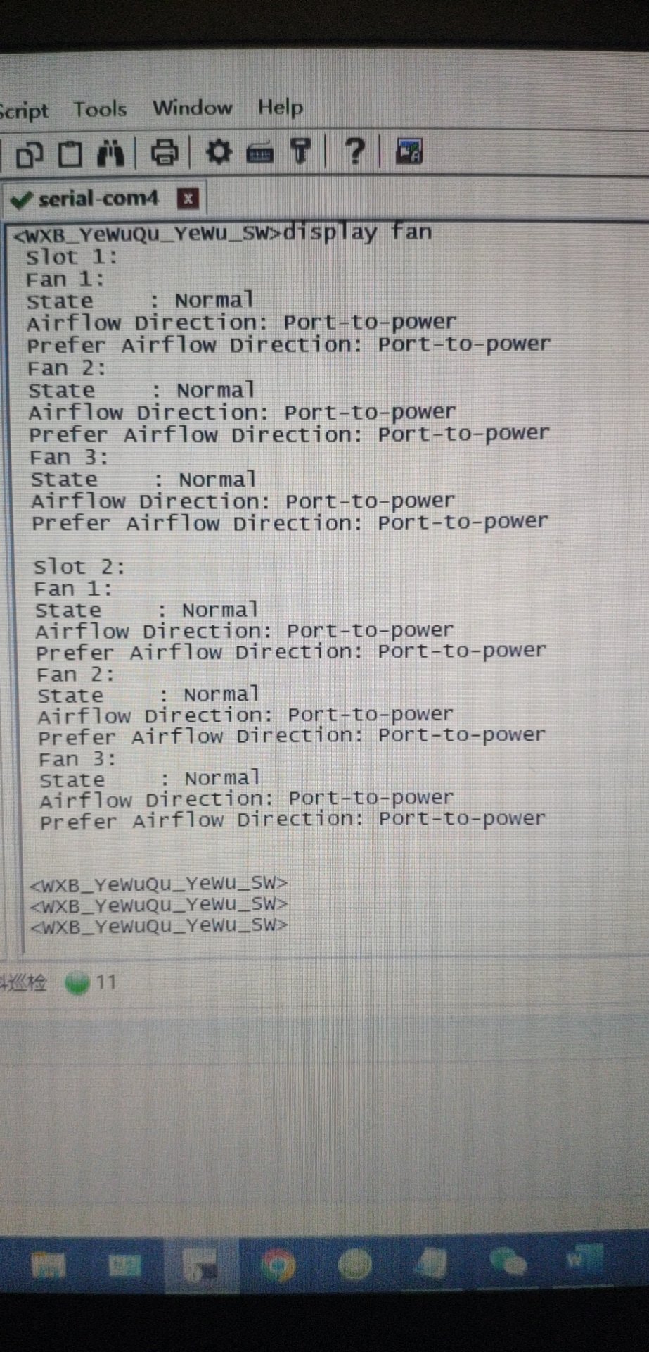

修改风道即可
修改过了,还是这样

请参考,
[H3C]fan prefer-direction slot 1 ?
port-to-power    From port to power
power-to-port    From power to port

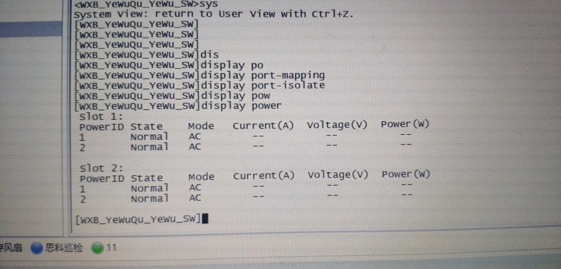

参考这个案例:
https://zhiliao.h3c.com/Theme/details/161779
您好,fan prefer-direction slot 1修改下风道
修改过了,没用
