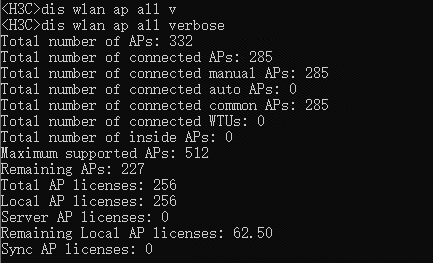

现象:
<H3C>dis wlan ap all verbose
Total number of APs: 332
 Total number of connected APs: 285
Total number of connected manual APs: 285
Total number of connected auto APs: 0
Total number of connected common APs: 285
Total number of connected WTUs: 0
Total number of inside APs: 0 Maximum supported APs: 512 Remaining APs: 227
Total AP licenses: 256 Local AP licenses: 256 Server AP licenses: 0 Remaining Local AP licenses: 62.50 Sync AP licenses: 0
以上信息中,在不增加授权的情况下,这台AC还可以管理多少个AP?

62.5
Remaining AP licenses 剩余AP license数量,不同的AP类型所占用的AP License数量不同,例如WA4320i-ACN占用1个AP License,WT1020不占用AP License,WTU420H占用0.25个AP License

你好,这个是从这条信息中“Remaining Local AP licenses: 62.50 ”看出本控制器还可以纳管62.5个AP吗?
zhiliao_oxRfgW 发表时间:2022-07-20
IT钟点工 发表时间:2022-07-20
0
可以配置,但是不能上线
叫我靓仔 发表时间:2022-07-20 更多>>
你好,这个是那条信息中表明了不能在纳管AP了
可以配置,但是不能上线
您好,还有62.5个,参考
