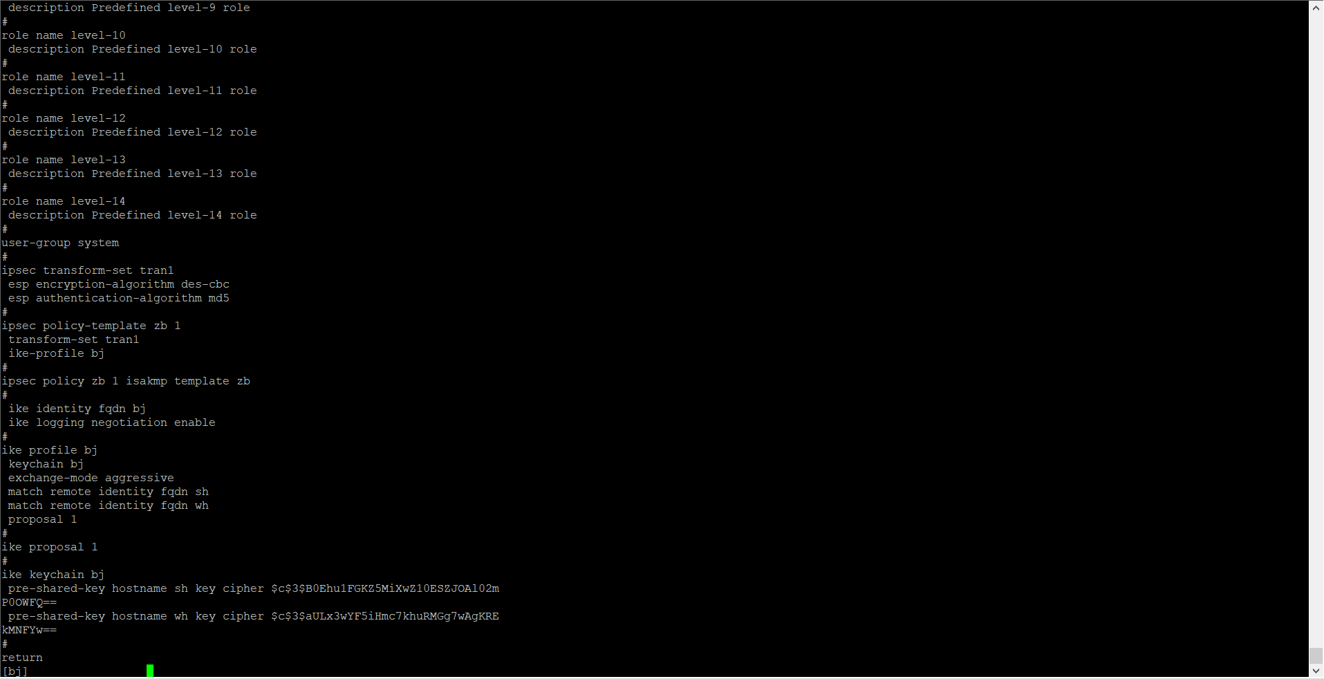

提示 %Jul 26 14:42:19:728 2022 bj IKE/6/IKE_P2_SA_ESTABLISH_FAIL: Failed to establish phase 2 SA in IKE_P2_STATE_GETSP state. Reason: Failed to get IPsec policy as phase 2 responder. SA information: Role: responder Local address: 100.1.1.1 Remote address: 101.1.1.2 Sour addr: / Port: 0 Protocol: Dest addr: / Port: 0 Protocol: Inside VPN instance: Outside VPN instance: Inbound AH SPI: 0 Outbound AH SPI: 0 Inbound ESP SPI: 0 Outbound ESP SPI: 0 Initiator COOKIE: 8cbfda2a2df87eb1 Responder COOKIE: d150e5236e284717 Message ID: 0x275c4d37 Connection ID: 89
两边的参数再检查检查,你截图的只有一侧的
是两侧呀,bj是总部,sh是分支
无名领域T 发表时间:2022-07-26 更多>>
是两侧呀,bj是总部,sh是分支
