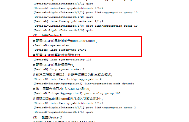

配置不成功。请问这个怎么解决。 报错如下。
[XYD_YYGA_SR8804X]irf mac-address A069-D947-8FC1 Operation failed. [XYD_YYGA_SR8804X]%Jul 27 10:51:24:070 2022 XYD_YYGA_SR8804X DRVPLAT/4/DrvDebug: -MDC=1; Incorrect IRF bridge MAC address. Make sure the lowest 11 bits of the IRF bridge MAC address are all zeros.
[XYD_YYGA_SR8804X]irf mac-address 0001-0001-0001 Operation failed. [XYD_YYGA_SR8804X]%Jul 27 10:49:53:331 2022 XYD_YYGA_SR8804X DRVPLAT/4/DrvDebug: -MDC=1; Incorrect IRF bridge MAC address. Make sure the lowest 11 bits of the IRF bridge MAC address are all zeros.
您好,是否设置了IRF mac保留时间
