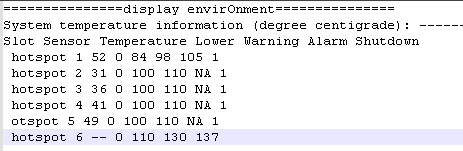

命令行dis environment看下,偶尔一次可以不用管
截图上的温度都是正常的

===============display envirOnment=============== System temperature information (degree centigrade): ---------------------------------------------------------------------- Slot Sensor Temperature Lower Warning Alarm Shutdown 1 hotspot 1 52 0 84 98 105 1 hotspot 2 31 0 100 110 NA 1 hotspot 3 36 0 100 110 NA 1 hotspot 4 41 0 100 110 NA 1 hotspot 5 49 0 100 110 NA 1 hotspot 6 -- 0 110 130 137
