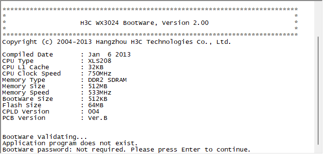

之前因为版本问题升了几轮 直接就oap 无法找到底层交换模块
然后 最后准备给设备重新升级一轮,用xmodel升级,挂了一个晚上第二天就进不去了,在要挂掉之前用的是115200的波特率
理论上应该是升级完毕了,但现在是开机9600能显示,115200不能显示
然后,每次卡BootWare password: Not required. Please press Enter to continue.
波特率怎么改都没用

格式化下,bootrom重新刷下看看呢,没有其他方法了
我就是手贱格式化了才这样,刚刚能进bootrom了,突然的。。。。然后现在又卡开机app 界面了

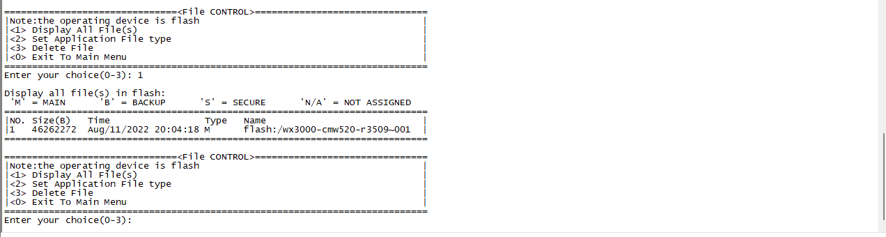

重启设备,当出现“Press Ctrl+B to enter extend boot menu...”时,键入<Ctrl+B>,系统提示:
按下<Enter>键后,系统进入BootWare主菜单:
Password recovery capability is enabled.
Note: The current operating device is flash
Enter < Storage Device Operation > to select device.
===========================<EXTEND-BOOTWARE MENU>===========================
|<1> Boot System                                                           |
|<2> Enter Serial SubMenu                                                  |
|<3> Enter Ethernet SubMenu                                                |
|<4> File Control                                                          |
|<5> Restore to Factory Default Configuration                              |
|<6> Skip Current System Configuration                                     |
|<7> BootWare Operation Menu                                               |
|<8> Clear Super Password                                                  |
|<9> Storage Device Operation                                              |
|<0> Reboot                                                                |
Ctrl+C: Display Copyright
Ctrl+F: Format File System
Enter your choice(0-9):
(2)      以太网子菜单
在BootWare主菜单下键入<3>,进入以太网子菜单,系统显示如下:
==========================<Enter Ethernet SubMenu>==========================
|Note:the operating device is flash                                        |
|<1> Download Application Program To SDRAM And Run                         |
|<2> Update Main Application File                                          |
|<3> Modify Ethernet Parameter                                             |
|<0> Exit To Main Menu                                                     |
|<Ensure The Parameter Be Modified Before Downloading!>
此界面再次选择     <3> Modify Ethernet Parameter
配置以太网口参数
在通过以太网口升级应用程序前,需要对AP的以太网口进行配置,请按如下进行配置:
在BootWare主菜单中键入<3>,进入以太网子菜单,然后键入<5>进入以太网口配置菜单:
============================<ETHERNET PARAMETER SET>======================
|Note:       '.' = Clear field.                                          |
|            '-' = Go to previous field.                                 |
|          Ctrl+D = Quit.                                                |
Protocol (FTP or TFTP) :tftp
Load File Name         :MSR3600xxxx.BIN
Target File Name       :MSR3600xxxx.BIN
Server IP Address      :192.168.0.1
Local IP Address       :192.168.0.50   (将连接的电脑地址设置成192.168.0.50,并启动tftp软件,将下载的版本文件 MSR3600xxxx.BIN  ,并放在tftp的根目录下以实际文件名为准)
Gateway IP Address     :
FTP User Name          :
FTP User Password      :
以上配置均完成后,在BootWare主菜单下键入<2> Update Main Application File  ,系统开始升级主应用程序:
升级完成后键入<0>,返回BootWare主菜单,然后键入<1>,启动系统

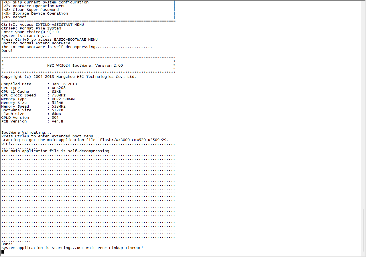

啊。。。。之前直接进不到这个界面里面来这回进来了。。。然后出现了下面的那个图片 我待会编辑发出来一下 卡开机了

现在就卡在图system app 界面 一直显示RFC WAIT peer linkup timeout 。。。。
啊。。。。我感觉 我买个二手回家玩 真的 。。折腾。。。哭哭
