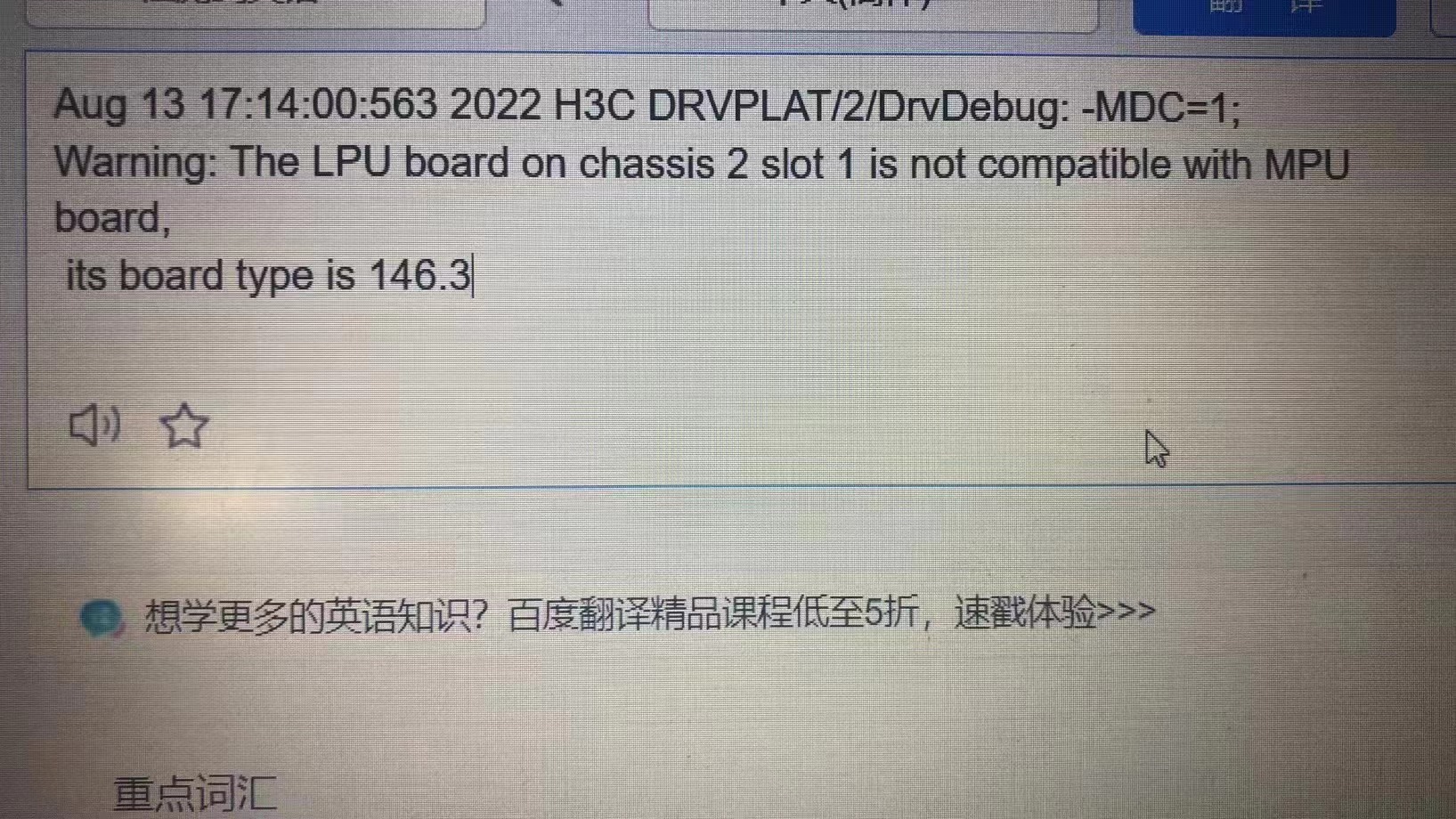

交换机主控板报下面日志是什么情况 是插错槽位了吗

日志信息
您好,Warning: Standby board on slot 1 is not compatible with master board.”或“Warning: The LPU board on slot 1 is not compatible with MPU board.”提示信息,这种情况是业务板、备用主控板或网板与主用主控板的设备标识不一致,请联系400热线或者采购渠道H3C认证代理商方面处理。

   确认日志中重启时有无出现类似“Warning: Standby board on slot 1 is not compatible with master board.”或“Warning: The LPU board on slot 1 is not compatible with MPU board.”提示信息,这种情况是业务板、备用主控板或网板与主用主控板的设备标识不一致,请联系技术支持人员更换。
