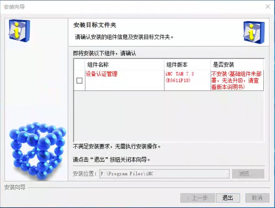

imc在软件安装升级部署EIA的时候提示不满足安装基础要求。如下图:
查看日志如下:
2022-08-17 14:54:46 [INFO ] [SwingWorker-pool-3-thread-1] [com.h3c.imc.deploy.install.wizard.InstallFolderChoosePanelDescriptor::checkComponentsShouldBeInstall(645)] compId:iMC-NETASSET 2022-08-17 14:54:46 [INFO ] [SwingWorker-pool-3-thread-1] [com.h3c.imc.deploy.install.wizard.InstallFolderChoosePanelDescriptor::checkComponentsShouldBeInstall(646)] version:7.3-E0706 2022-08-17 14:54:46 [INFO ] [SwingWorker-pool-3-thread-1] [com.h3c.imc.deploy.install.wizard.InstallFolderChoosePanelDescriptor::checkComponentsShouldBeInstall(647)] innerVer:V700R001B06D028 2022-08-17 14:54:46 [INFO ] [SwingWorker-pool-3-thread-1] [com.h3c.imc.deploy.install.wizard.InstallFolderChoosePanelDescriptor::checkComponentsShouldBeInstall(645)] compId:iMC-LOCATE-ENGIN 2022-08-17 14:54:46 [INFO ] [SwingWorker-pool-3-thread-1] [com.h3c.imc.deploy.install.wizard.InstallFolderChoosePanelDescriptor::checkComponentsShouldBeInstall(646)] version:7.3-E0610 2022-08-17 14:54:46 [INFO ] [SwingWorker-pool-3-thread-1] [com.h3c.imc.deploy.install.wizard.InstallFolderChoosePanelDescriptor::checkComponentsShouldBeInstall(647)] innerVer:V700R008B01D023 2022-08-17 14:54:46 [INFO ] [SwingWorker-pool-3-thread-1] [com.h3c.imc.deploy.install.wizard.InstallFolderChoosePanelDescriptor::checkComponentsShouldBeInstall(645)] compId:iMC-LOCATE 2022-08-17 14:54:46 [INFO ] [SwingWorker-pool-3-thread-1] [com.h3c.imc.deploy.install.wizard.InstallFolderChoosePanelDescriptor::checkComponentsShouldBeInstall(646)] version:7.3-E0610 2022-08-17 14:54:46 [INFO ] [SwingWorker-pool-3-thread-1] [com.h3c.imc.deploy.install.wizard.InstallFolderChoosePanelDescriptor::checkComponentsShouldBeInstall(647)] innerVer:V700R008B01D023 2022-08-17 14:54:46 [INFO ] [SwingWorker-pool-3-thread-1] [com.h3c.imc.deploy.install.wizard.InstallFolderChoosePanelDescriptor::checkComponentsShouldBeInstall(645)] compId:iMC-ICC 2022-08-17 14:54:46 [INFO ] [SwingWorker-pool-3-thread-1] [com.h3c.imc.deploy.install.wizard.InstallFolderChoosePanelDescriptor::checkComponentsShouldBeInstall(646)] version:7.3-E0706 2022-08-17 14:54:46 [INFO ] [SwingWorker-pool-3-thread-1] [com.h3c.imc.deploy.install.wizard.InstallFolderChoosePanelDescriptor::checkComponentsShouldBeInstall(647)] innerVer:V700R001B06D028 2022-08-17 14:54:46 [INFO ] [SwingWorker-pool-3-thread-1] [com.h3c.imc.deploy.install.wizard.InstallFolderChoosePanelDescriptor::checkComponentsShouldBeInstall(645)] compId:iMC-DM 2022-08-17 14:54:46 [INFO ] [SwingWorker-pool-3-thread-1] [com.h3c.imc.deploy.install.wizard.InstallFolderChoosePanelDescriptor::checkComponentsShouldBeInstall(646)] version:7.3-E0706 2022-08-17 14:54:46 [INFO ] [SwingWorker-pool-3-thread-1] [com.h3c.imc.deploy.install.wizard.InstallFolderChoosePanelDescriptor::checkComponentsShouldBeInstall(647)] innerVer:V700R001B06D028 2022-08-17 14:54:46 [INFO ] [SwingWorker-pool-3-thread-1] [com.h3c.imc.deploy.install.wizard.InstallFolderChoosePanelDescriptor::checkComponentsShouldBeInstall(649)] ------------- 2022-08-17 14:54:46 [INFO ] [SwingWorker-pool-3-thread-1] [com.h3c.imc.deploy.install.wizard.InstallFolderChoosePanelDescriptor::checkComponentsShouldBeInstall(650)] 不需要安装的组件列表 2022-08-17 14:54:46 [INFO ] [SwingWorker-pool-3-thread-1] [com.h3c.imc.deploy.install.wizard.InstallFolderChoosePanelDescriptor::checkComponentsShouldBeInstall(652)] compId:iMC-TAM 2022-08-17 14:54:46 [INFO ] [SwingWorker-pool-3-thread-1] [com.h3c.imc.deploy.install.wizard.InstallFolderChoosePanelDescriptor::checkComponentsShouldBeInstall(653)] version:7.3-E0611P18 2022-08-17 14:54:46 [INFO ] [SwingWorker-pool-3-thread-1] [com.h3c.imc.deploy.install.wizard.InstallFolderChoosePanelDescriptor::checkComponentsShouldBeInstall(654)] innerVer:V700R003B05D042SP18 2022-08-17 14:54:46 [INFO ] [SwingWorker-pool-3-thread-1] [com.h3c.imc.deploy.install.wizard.InstallFolderChoosePanelDescriptor::checkComponentsShouldBeInstall(656)] ------------- 2022-08-17 14:54:46 [INFO ] [SwingWorker-pool-3-thread-1] [com.h3c.imc.deploy.install.wizard.InstallFolderChoosePanelDescriptor::checkComponentsShouldBeInstall(665)] 增加数据库的检查,对于升级版本,不需要检查,不可能再切换数据库了。只需要检查未安装过的组件 2022-08-17 14:54:46 [INFO ] [SwingWorker-pool-3-thread-1] [com.h3c.imc.deploy.install.wizard.InstallFolderChoosePanelDescriptor::checkComponentsShouldBeInstall(667)] 需要检查的组件 2022-08-17 14:54:46 [INFO ] [SwingWorker-pool-3-thread-1] [com.h3c.imc.deploy.install.wizard.InstallFolderChoosePanelDescriptor::checkComponentsShouldBeInstall(673)] ------------- 2022-08-17 14:54:46 [INFO ] [SwingWorker-pool-3-thread-1] [com.h3c.imc.deploy.install.wizard.InstallFolderChoosePanelDescriptor::checkComponentsShouldBeInstall(679)] current db type is : MySQL 2022-08-17 14:54:46 [INFO ] [SwingWorker-pool-3-thread-1] [com.h3c.imc.deploy.install.wizard.InstallFolderChoosePanelDescriptor::checkComponentsShouldBeInstall(682)] check db components size : 0 2022-08-17 14:54:46 [INFO ] [SwingWorker-pool-3-thread-1] [com.h3c.imc.deploy.install.wizard.InstallFolderChoosePanelDescriptor::checkComponentsShouldBeInstall(683)] 首先判断当前数据库类型,如果为空,则不处理.只处理当前数据库类型不为空,且需要检查数据库的组件数目大于0的情况 2022-08-17 14:54:46 [INFO ] [SwingWorker-pool-3-thread-1] [com.h3c.imc.deploy.install.wizard.InstallFolderChoosePanelDescriptor::checkComponentsShouldBeInstall(780)] 逐个判断组件的依赖性,如果依赖性不满足要求,则不允许安装。
求各位大佬帮忙分析是什么原因导致,如何去解决该问题。

页面提示很明显,没装基础组件,你得先安装TAM E0611,在升级P18的补丁版本
IMC的版本需要和组件的版本有配套关系,你看下你这个组件的说明书,里面有适配的IMC的版本号范围
粉丝:5人 关注:0人
检查TAM基础版本0611是否已经安装了,也检查下平台版本是否适配
