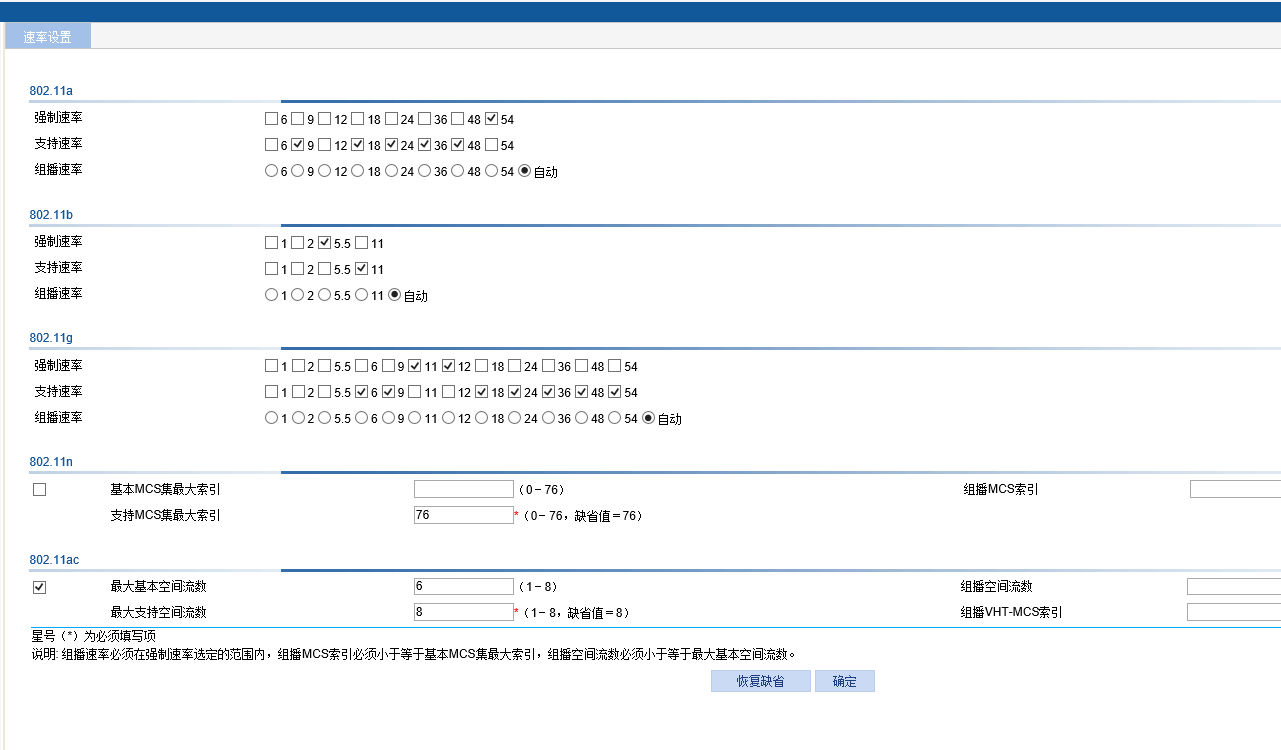

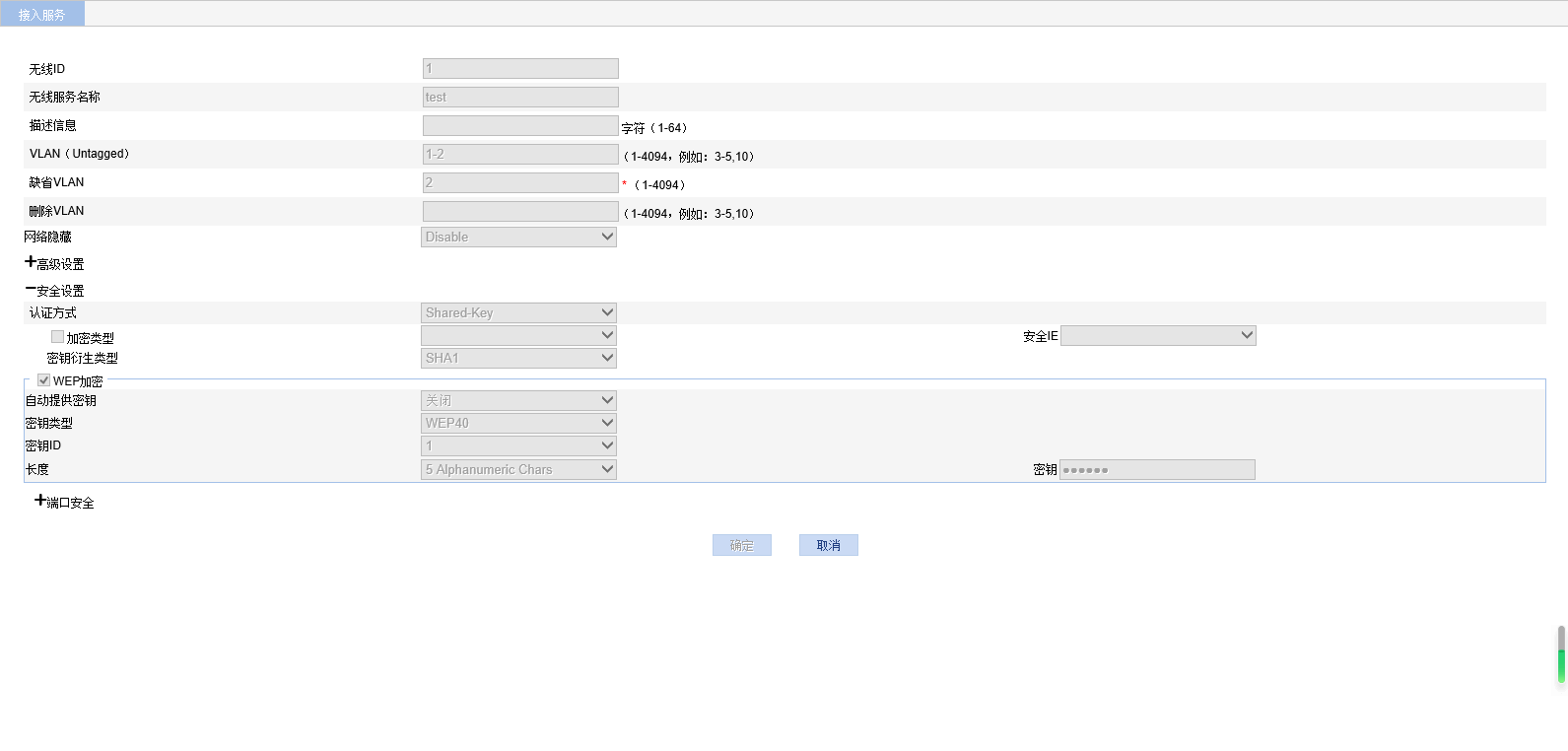

胖AP  手机距离ap 半米  722E最大支持300m的速率  但是手机连上只有54m
查看信息,发现手机连上了11.a 这个模式,这个模式最大就是54m
但是设置界面有802.ac  802.n这两个模式
Total Number of Clients : 1 Client Information ------------------------------------------------------------------------------- MAC Address : 9cbc-f0e9-8098 User Name : -NA- IP Address : 192.168.1.1 IPv6 Address : -NA- AID : 1 Radio Interface : WLAN-Radio1/0/1 Service Template Number : 1 SSID : test BSSID : 60da-8391-6e80 Port : WLAN-BSS32 VLAN : 2 State : Running Power Save Mode : Sleep Wireless Mode : 11a QoS Mode : WMM Listen Interval (Beacon Interval) : 1 RSSI : 37 Rx/Tx Rate : 54/54 Client Type : PRE-RSNA Authentication Method : Shared Key Authentication Mode : Central AKM Method : None Key Derivation : -NA- 4-Way Handshake State : -NA- Group Key State : -NA- Encryption Cipher : WEP40 PMF Status : -NA- Roam Status : Normal Roam Count : 0 Up Time (hh:mm:ss) : 00:00:06
这里有802.11n 和802.11ac  这里是支持更大的速率的,但是 手机只连上了 802.11a
[WAP722E-wlan-st-1]dis current-configuration # version 5.20, Release 1507P04 # sysname WAP722E # domain default enable system # telnet server enable # port-security enable # password-recovery enable # undo attack-defense tcp fragment enable # acl number 3000 rule 0 permit ip # vlan 1 # vlan 2 # domain system access-limit disable state active idle-cut disable self-service-url disable # dhcp server ip-pool 0 network 192.168.1.0 mask 255.255.255.0 gateway-list 192.168.1.254 dns-list 202.96.128.86 # user-group system group-attribute allow-guest # local-user admin password cipher $c$3$AmKij37ldbjqhWy3c60NThu4h4cy1/OTPA3Q6RA= authorization-attribute level 3 service-type telnet service-type web # wlan rrm dot11a mandatory-rate 54 dot11a supported-rate 9 18 24 36 48 dot11a disabled-rate 6 12 dot11b mandatory-rate 5.5 dot11b supported-rate 11 dot11b disabled-rate 1 2 dot11g mandatory-rate 11 12 dot11g supported-rate 6 9 18 24 36 48 54 dot11g disabled-rate 1 2 5.5 # wlan service-template 1 crypto ssid test undo authentication-method open-system authentication-method shared-key cipher-suite wep40 wep default-key 1 wep40 pass-phrase cipher $c$3$KPXbFGIGxIis5B3oEWg7YfIwA+6aTStW service-template enable # cwmp undo cwmp enable # interface NULL0 # interface Vlan-interface1 ip address 176.16.10.20 255.255.255.0 nat outbound 3000 # interface Vlan-interface2 ip address 192.168.1.254 255.255.255.0 # interface GigabitEthernet1/0/1 # interface GigabitEthernet1/0/2 # interface WLAN-BSS32 port link-type hybrid port hybrid vlan 1 to 2 untagged port hybrid pvid vlan 2 # interface WLAN-BSS33 port link-type hybrid port hybrid vlan 1 to 2 untagged port hybrid pvid vlan 2 # interface WLAN-Radio1/0/1 channel 153 service-template 1 interface wlan-bss 32 # interface WLAN-Radio1/0/2 service-template 1 interface wlan-bss 33 # ip route-static 0.0.0.0 0.0.0.0 176.16.10.254 # dhcp enable #

加密算法和套件的问题
通过命令行的方式 ,在服务模板下这么些就可以了
cipher-suite ccmp
cipher-suite tkip
security-ie rsn
security-ie wpa
web 页面选择这样的
你改成不加密的试试

版本差别很大 麻烦请看贴子的新图

协商成54M就是认证算法和套件的问题,我这个图是在控制器上截的,手里没有胖AP。
zhiliao_h907dg 发表时间:2022-08-17
你改成不加密的试试
