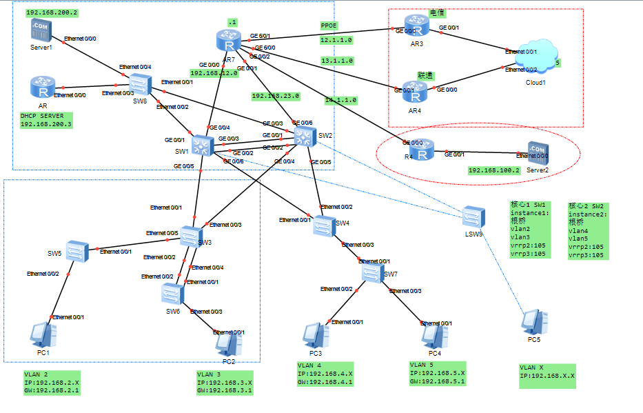

MSTP+VRRP
2022-09-02提问
  • 0收藏,2308浏览
SW1
 vlan batch 2 to 5 200 to 201 999
# stp instance 1 root primary stp instance 2 root secondary
# stp region-configuration
 region-name a
 instance 1 vlan 2 to 3 200
 instance 2 vlan 4 to 5
 active region-configuration
# interface Vlanif2
 ip address 192.168.2.253 255.255.255.0
 vrrp vrid 2 virtual-ip 192.168.2.254 vrrp vrid 2 priority 105
# interface Vlanif3
 ip address 192.168.3.253 255.255.255.0
 vrrp vrid 3 virtual-ip 192.168.3.254 vrrp vrid 3 priority 105
 # interface Vlanif4
 ip address 192.168.4.253 255.255.255.0
 vrrp vrid 4 virtual-ip 192.168.4.254
# interface Vlanif5
 ip address 192.168.5.253 255.255.255.0
 vrrp vrid 5 virtual-ip 192.168.5.254
 # interface Eth-Trunk2 port link-type trunk
 port trunk allow-pass vlan 2 to 5 30 200 to 202 300 999
 mode lacp-static
# interface GigabitEthernet0/0/1
 port link-type trunk port trunk allow-pass vlan 200 999
# interface GigabitEthernet0/0/2 eth-trunk 2
# interface GigabitEthernet0/0/3 eth-trunk 2
 # interface GigabitEthernet0/0/4
 port link-type access port default vlan 201
 # interface GigabitEthernet0/0/5
 port trunk allow-pass vlan 2 to 3 999
# interface GigabitEthernet0/0/6
 port link-type trunk port trunk allow-pass vlan 4 to 5 999
 SW2
 vlan batch 2 to 5 200 999
# stp instance 1 root secondary
stp instance 2 root primary
 region-name a
 # interface Vlanif2
 ip address 192.168.2.252 255.255.255.0
 # interface Vlanif3
 ip address 192.168.3.252 255.255.255.0
 # interface Vlanif4
 ip address 192.168.4.252 255.255.255.0
 vrrp vrid 4 virtual-ip 192.168.4.254 vrrp vrid 4 priority 105
 # interface Vlanif5
 ip address 192.168.5.252 255.255.255.0
 vrrp vrid 5 virtual-ip 192.168.5.254 vrrp vrid 5 priority 105
 port trunk allow-pass vlan 2 to 5 200 to 202 300 999
 mode lacp-static
 eth-trunk 2
 eth-trunk 2
 port trunk allow-pass vlan 202 999
SW3
 region-name a
# interface MEth0/0/1
 # interface Eth-Trunk1
 port trunk allow-pass vlan 3 999
 mode lacp-static
 # interface Ethernet0/0/1
 # interface Ethernet0/0/2
 eth-trunk 1
 # interface Ethernet0/0/3
 # interface Ethernet0/0/4
 eth-trunk 1
 # interface Ethernet0/0/5
port trunk allow-pass vlan 2 999
 sysname JR-SW6
# vlan batch 2 to 5 200 999
 mode lacp-static
 eth-trunk 1
 eth-trunk 1
 port link-type access port default vlan 3
 HJ-SW4
 region-name a
sysname JR-SW5
sysname SW7
 port link-type access port default vlan 4
 port link-type access port default vlan 5
SW8
 region-name a
 port link-type access port default vlan 200
这配置是哪里问题哦,vlan 2 3 都能拼网关,vlan4 5 都拼不通。

可以看一下MSTP状态,是不是有接口被阻塞了。

可以看看是不是MSTP阻塞了。
使用dis stp brief命令查看端口是否被阻塞了。
进一步检查MSTP和VRRP的配置。
