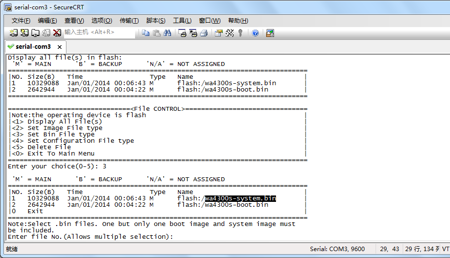

里面文件怎么不是fit
fywr 九段
粉丝:50人 关注:3人
V7 文件系统就是这样,一个system一个boot,bin文件;跟V5有差别

==========================<Enter Ethernet SubMenu>========================== |Note:the operating device is flash | |<1> Download Image Program To SDRAM And Run | |<2> Update Main Image File | |<3> Update Backup Image File | |<4> Download Files(*.*) | |<5> Modify Ethernet Parameter | |<0> Exit To Main Menu | |<Ensure The Parameter Be Modified Before Downloading!>

BootWare Validating... Press Ctrl+B to access EXTENDED-BOOTWARE MENU... Loading the main boot and system image files... The system image does not exist! Loading the backup boot and system image files... The image does not exist! Booting image fails! Trying to get the IP address from the DHCP server......

|NO. Size(B) Time Type Name | |1 11293696 Aug/08/2008 20:00:00 N/A flash:/wa4300s-cmw520-r1509p01-f| |at.bin
亚林 发表时间:2018-09-17
1 11293696 Aug/08/2008 20:00:00 N/A flash:/wa4300s-cmw520-r1509p01-fat.bin
