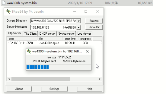

使用这个固件还是提示错误
Neko 发表时间:2022-09-23

Neko 知了小白
使用的是bootware菜单进行升级 以下是输出的信息
* H3C WA4320H-ACN-H20 BootWare, Version 7.10 *
Copyright (c) 2004-2017 New H3C Technologies Co., Ltd.
Compiled Date : Jun 15 2017
CPU Type : ATHEROS AR9563
CPU L1 Cache : 32KB
CPU Clock Speed : 775MHz
Memory Type : SDRAM
Memory Size : 128MB
Memory Speed : 560MHz
BootWare Size : 512KB
Flash Size : 16MB
PCB Version : Ver.B
==========================<EXTENDED-BOOTWARE MENU>==========================
|<1> Boot System |
|<2> Enter Serial SubMenu |
|<3> Enter Ethernet SubMenu |
|<4> File Control |
|<5> Restore to Factory Default Configuration |
|<6> Skip Current System Configuration |
|<7> BootWare Operation Menu |
|<8> Skip Authentication for Console Login |
|<9> Storage Device Operation |
|<0> Reboot |
Ctrl+Z: Access EXTENDED ASSISTANT MENU
Ctrl+F: Format File System
Ctrl+C: Display Copyright
Enter your choice(0-9): 3
==========================<Enter Ethernet SubMenu>==========================
|Note:the operating device is flash |
|<1> Download Image Program To SDRAM And Run |
|<2> Update Main Image File |
|<3> Update Backup Image File |
|<4> Download Files(*.*) |
|<5> Modify Ethernet Parameter |
|<0> Exit To Main Menu |
|<Ensure The Parameter Be Modified Before Downloading!> |
Enter your choice(0-5): 2
Loading.....................................................................
Done.
11118592 bytes downloaded!
Something wrong with the file.
