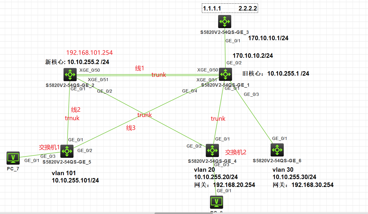

新核心与旧核心链路聚合,底下接入默认路由到新核心,新旧核心线路中断,接入无法从另一条线过去
2022-09-24提问
  • 0收藏,2816浏览
阿白 零段
新核心与旧核心两链路聚合,新核心默认路由到旧核心。新旧核心之间做VRRP,新核心为vlan101的主设备 ,接入交换机1 的网关:192.168.101.254 在新核心上,直接默认路由到新核心。现在如果把新旧之间的线路down了,接入交换机1没法通过另一根到旧核心去。pc7没法ping通1.1.1.1。如果线1DOWN了后,想让交换机1能自动走线3.但是交换机1的默认路由中新核心的,走线2上去。

新核心的配置的可以发一下吗
新核心配置: System View: return to User View with Ctrl+Z. [new-hexi]dis cu # version 7.1.075, Alpha 7571 # sysname new-hexi # irf mac-address persistent timer irf auto-update enable undo irf link-delay irf member 1 priority 1 # ip unreachables enable ip ttl-expires enable # lldp global enable # system-working-mode standard xbar load-single password-recovery enable lpu-type f-series # vlan 1 # vlan 20 # vlan 30 # vlan 101 # vlan 255 # stp global enable # interface Bridge-Aggregation1 port link-type trunk undo port trunk permit vlan 1 port trunk permit vlan 20 30 101 255 # interface NULL0 # interface Vlan-interface20 vrrp vrid 2 virtual-ip 192.168.20.254 # interface Vlan-interface101 ip address 192.168.101.254 255.255.255.0 vrrp vrid 1 virtual-ip 192.168.101.254 vrrp vrid 1 priority 120 # interface Vlan-interface255 ip address 10.10.255.2 255.255.255.0 # interface FortyGigE1/0/53 port link-mode bridge # interface FortyGigE1/0/54 port link-mode bridge # interface GigabitEthernet1/0/1 port link-mode bridge port link-type trunk undo port trunk permit vlan 1 port trunk permit vlan 101 255 combo enable fiber # interface GigabitEthernet1/0/2 port link-mode bridge port link-type trunk undo port trunk permit vlan 1 port trunk permit vlan 20 255 combo enable fiber # interface GigabitEthernet1/0/3 port link-mode bridge combo enable fiber # # interface Ten-GigabitEthernet1/0/50 port link-mode bridge port link-type trunk undo port trunk permit vlan 1 port trunk permit vlan 20 30 101 255 combo enable fiber port link-aggregation group 1 # interface Ten-GigabitEthernet1/0/51 port link-mode bridge port link-type trunk undo port trunk permit vlan 1 port trunk permit vlan 20 30 101 255 combo enable fiber port link-aggregation group 1 # user-role network-operator # ip route-static 0.0.0.0 0 10.10.255.1 # 交换机1配置: <vlan101-sw>dis cu # version 7.1.075, Alpha 7571 # sysname vlan101-sw # irf mac-address persistent timer irf auto-update enable undo irf link-delay irf member 1 priority 1 # ip unreachables enable ip ttl-expires enable # lldp global enable # system-working-mode standard xbar load-single password-recovery enable lpu-type f-series # vlan 1 # vlan 101 # vlan 255 # stp global enable # nqa entry admin admin type icmp-echo # interface NULL0 # interface LoopBack3 ip address 3.3.3.3 255.255.255.255 # interface Vlan-interface255 ip address 10.10.255.101 255.255.255.0 # interface FortyGigE1/0/53 port link-mode bridge # interface FortyGigE1/0/54 port link-mode bridge # interface GigabitEthernet1/0/1 port link-mode bridge port link-type trunk undo port trunk permit vlan 1 port trunk permit vlan 101 255 combo enable fiber # interface GigabitEthernet1/0/2 port link-mode bridge port link-type trunk undo port trunk permit vlan 1 port trunk permit vlan 101 255 combo enable fiber # interface GigabitEthernet1/0/3 port link-mode bridge port access vlan 101 combo enable fiber # interface GigabitEthernet1/0/4 port link-mode bridge port access vlan 101 combo enable fiber # # ip route-static 0.0.0.0 0 10.10.255.2 ip route-static 0.0.0.0 0 10.10.255.1 #

新核心配置:
vlan 1
vlan 20
vlan 30
vlan 101
vlan 255
stp global enable
interface NULL0
combo enable fiber
combo enable fiber
combo enable fiber
combo enable fiber
combo enable fiber
交换机1配置:
<vlan101-sw>dis cu
sysname vlan101-sw
undo irf link-delay
lldp global enable
xbar load-single
lpu-type f-series
vlan 1
vlan 101
vlan 255
stp global enable
type icmp-echo
interface NULL0
interface LoopBack3
combo enable fiber
combo enable fiber
combo enable fiber
combo enable fiber
1、如果你用静态实现,如要配置NQA等动态检测技术
2、所以,你这个拓扑,接入、新旧核心跑个OSPF就行了,旧核心下发默认路由即可
王磊 知了小白
粉丝:0人 关注:2人
新核心,vrrp track联动和旧核心互联的口
