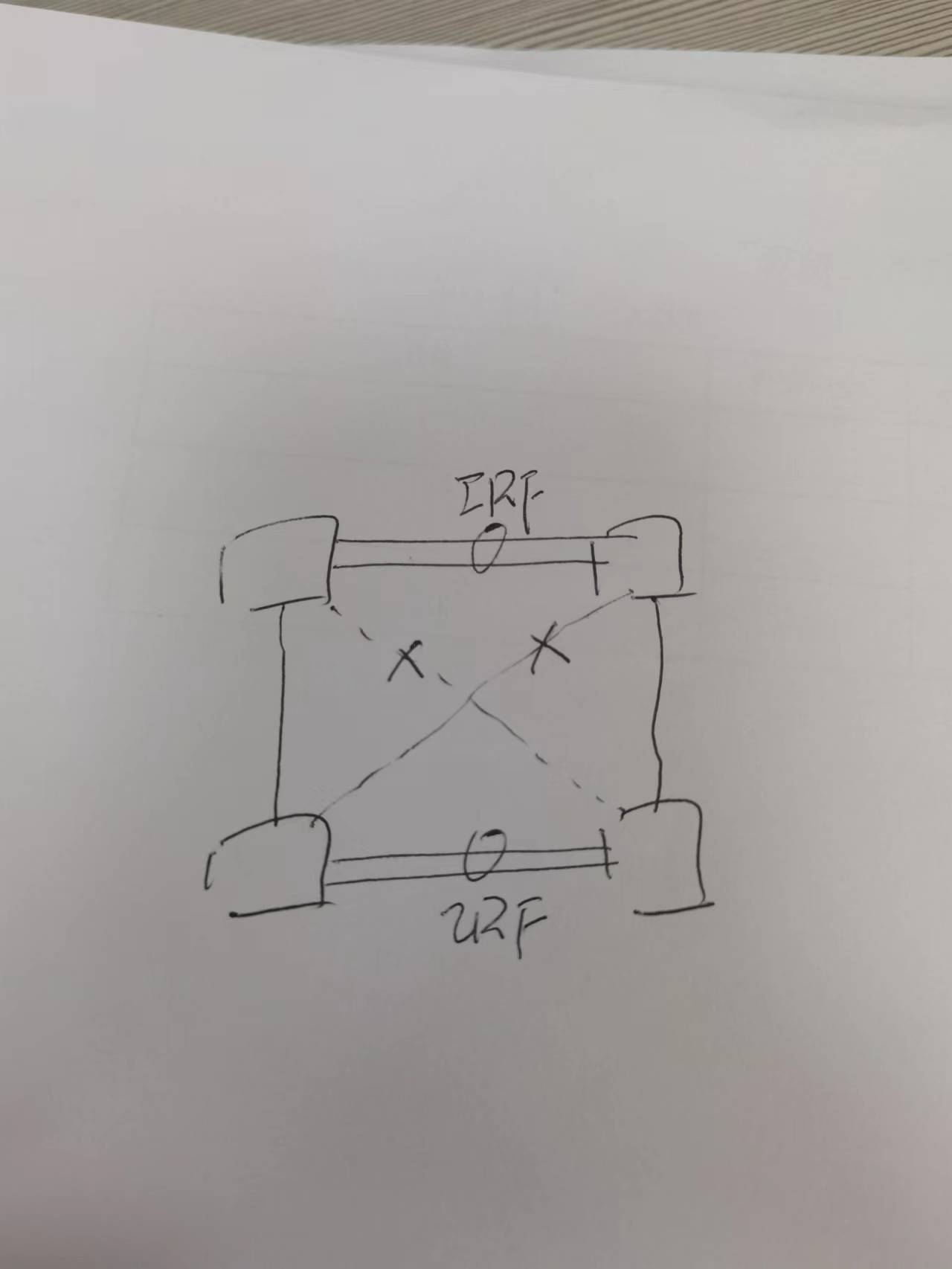

你好,如图,当虚线线缆断开时,跨三层的通信ping不通。H3C交换机IRF是否支持断开后的拓扑?
两组irf交换机互联的4根线加到一个聚合组里。

是在一个聚合组。模拟虚线断开时的场景,发现不通了

回复Captain:
正常不会的,检查一下聚合情况吧,应该是聚合的问题。

支持的,你是用模拟器做的吗

配置没问题,不通的时候建议看下日志、看下stp状态、看下链路聚合选举接口情况

实际网络

虚线和实现是怎么配置的,一个聚合组?

# interface Bridge-Aggregation35 description Link-To PRO-HXSW port link-type trunk port trunk permit vlan 1 to 3998 4000 to 4094 link-aggregation mode dynamic # # interface Ten-GigabitEthernet1/0/25 port link-mode bridge description To PRO-HXSW T1/6/0/11 port link-type trunk port trunk permit vlan 1 to 3998 4000 to 4094 port link-aggregation group 35 # interface Ten-GigabitEthernet1/0/26 port link-mode bridge description To PRO-HXSW T2/6/0/11 port link-type trunk port trunk permit vlan 1 to 3998 4000 to 4094 port link-aggregation group 35 # interface Ten-GigabitEthernet2/0/25 port link-mode bridge description To PRO-HXSW T1/6/0/11 port link-type trunk port trunk permit vlan 1 to 3998 4000 to 4094 port link-aggregation group 35 # interface Ten-GigabitEthernet2/0/26 port link-mode bridge description To PRO-HXSW T2/6/0/11 port link-type trunk port trunk permit vlan 1 to 3998 4000 to 4094 port link-aggregation group 35 #
Captain 发表时间:2022-10-17
4根线一个聚合组,配置如下
